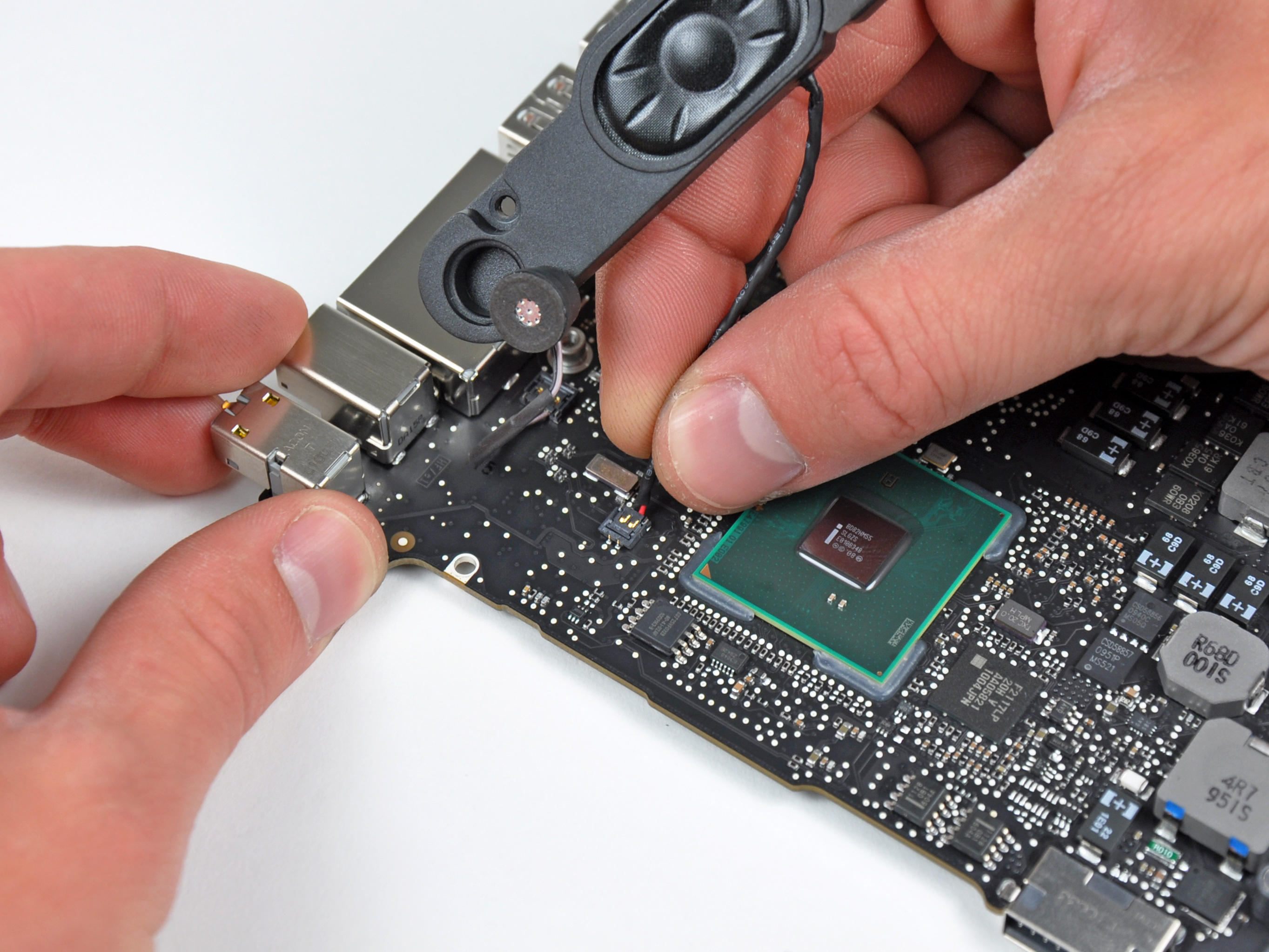

  • Lift the left fan out of the upper case.
Image #1
Add Note Edit Step 8 — Logic Board  ¶
  • Use the flat end of a spudger to lift the right fan connector out of its socket on the logic board.
  • It is useful to twist the spudger axially from beneath the fan cable wires to release the connector.
