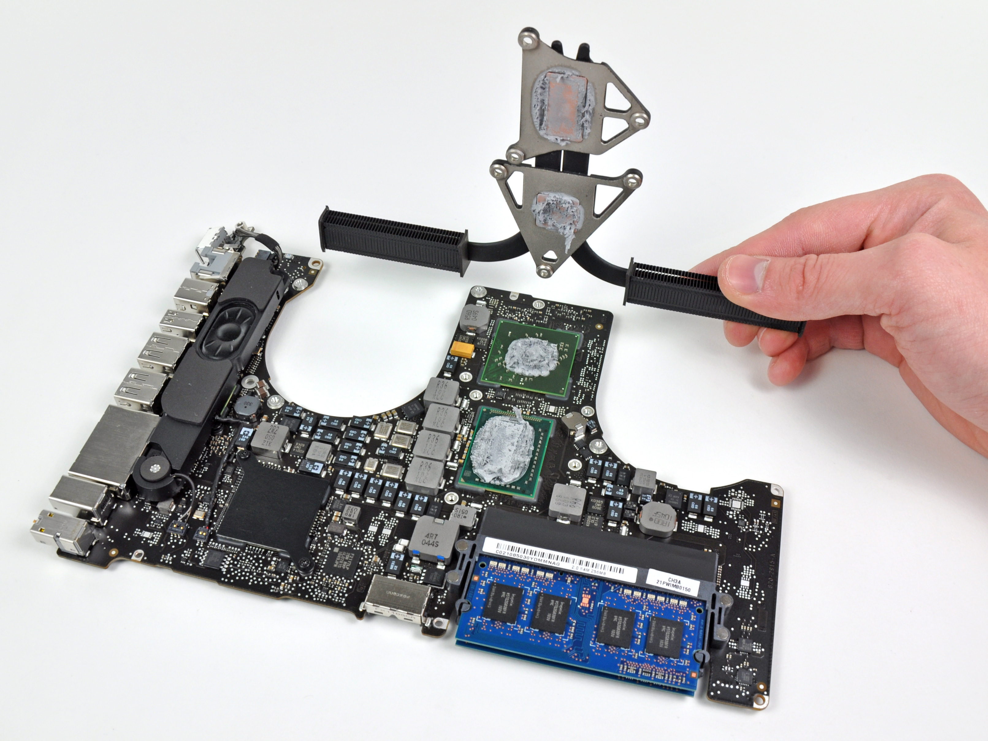

Image #1 Image #2
Add Note Edit Step 9  ¶
  • Remove the three 3.4 mm (3.1 mm) T6 Torx screws securing the right fan to the logic board.
  • Lift the right fan out of its opening in the logic board.
Image #1
Add Note Edit Step 10  ¶
  • Pull the camera cable out of its socket on the logic board.
  • Don't lift upward on the camera cable as you disconnect it. Pulling upward on the cable may damage both the cable and the logic board. Pull the cable parallel to the face of the logic board.
Image #1
Add Note Edit Step 11  ¶
  • Use the flat end of a spudger to pry the AirPort/Bluetooth connector up from its socket on the logic board.
Image #1
Add Note Edit Step 12  ¶
  • Use the flat end of a spudger to lift the optical drive connector out of its socket on the logic board.
Image #1
Add Note Edit Step 13  ¶
  • Disconnect the hard drive/IR sensor cable from its socket on the logic board by lifting up from beneath its connector.
Image #1
Add Note Edit Step 14  ¶
  • Use the flat end of a spudger to lift the subwoofer/right speaker connector out of its socket on the logic board.
  • Pry up from beneath the wires.
Image #1 Image #2
Add Note Edit Step 15  ¶
  • Remove the two 1.5 mm ( 1.2 mm ) Phillips screws securing the keyboard/trackpad cable cover to the logic board.
  • Lift the cover off the logic board and set it aside.
Image #1
Add Note Edit Step 16  ¶
  • Use the flat end of a spudger to pry the trackpad connector up and out of its socket on the logic board.
