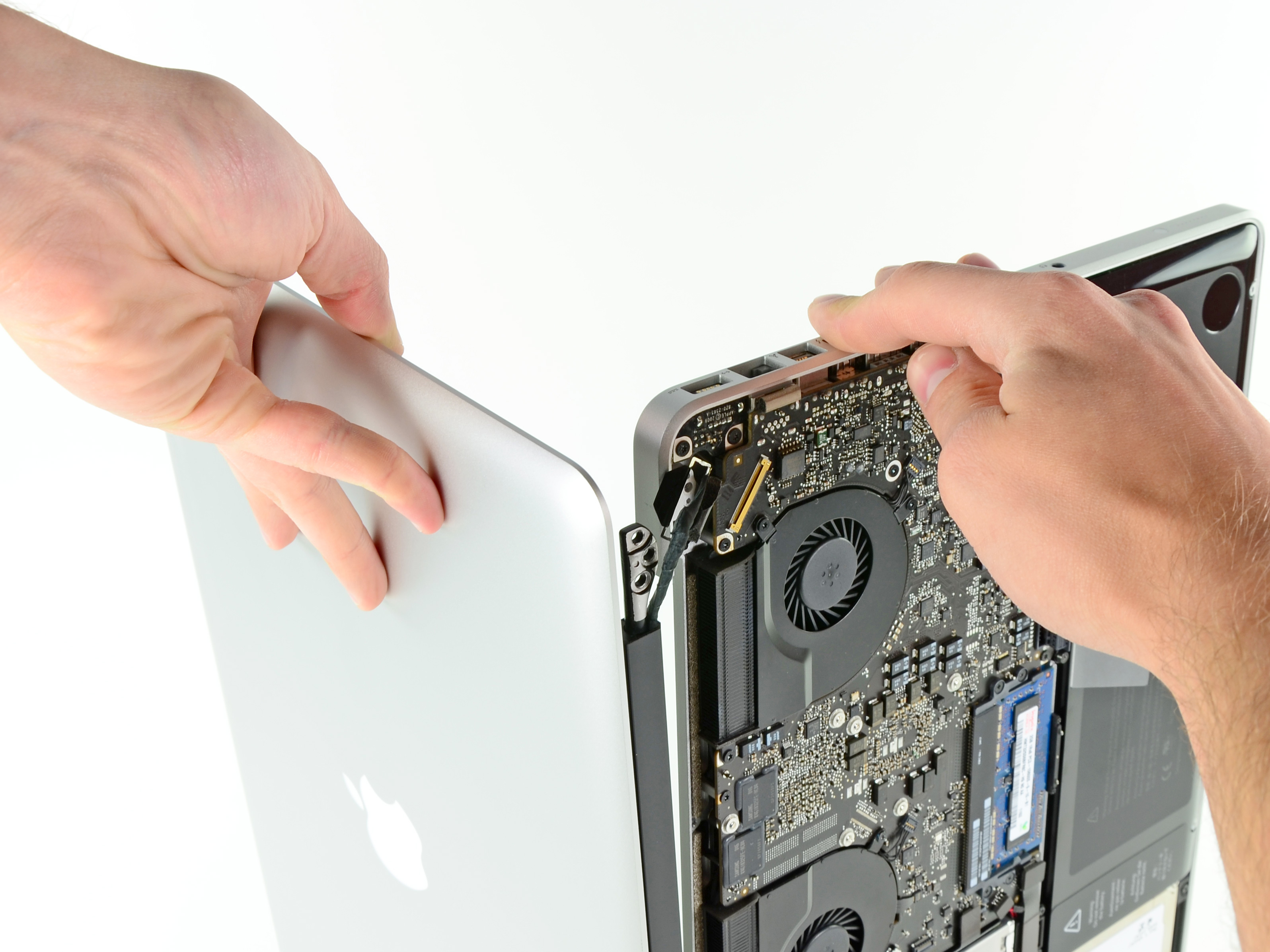

Add Note Edit Step 5 — AirPort/Bluetooth Board Assembly  ¶
  • Pull the camera cable connector straight out of its socket on the logic board.
  • Pull the cable parallel to the face of the logic board toward the optical drive opening.
Image #1
Add Note Edit Step 6  ¶
  • Use the flat end of a spudger to carefully pry the AirPort/Bluetooth ribbon cable up off its socket on the logic board.
Image #1 Image #2
Add Note Edit Step 7  ¶
  • Use the tip of a spudger to pry the four antenna connectors up from their sockets on the AirPort/Bluetooth board.
Image #1 Image #2 Image #3
Add Note Edit Step 8  ¶
  • De-route all four antenna cables from their channels in the AirPort/Bluetooth housing.
  • De-route the camera cable from its channel in the AirPort/Bluetooth housing.
