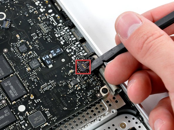

Add Note Edit Step 19  ¶
  • Using the flat end of a spudger, pry the microphone cable connector straight up off the logic board.
