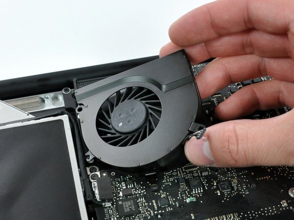

  • Lift both fans out of the upper case.
Image #1

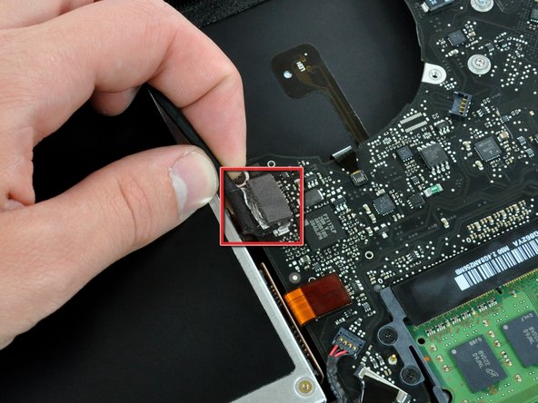

Add Note Edit Step 10  ¶
  • Disconnect the camera cable by pulling the male end straight away from its socket.
Image #1

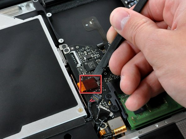

Add Note Edit Step 11  ¶
  • Use a spudger to pry the optical drive connector straight up off the logic board.
Image #1

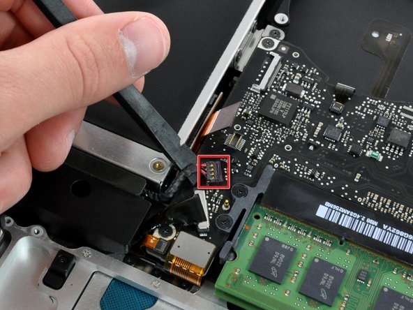

Add Note Edit Step 12  ¶
  • If necessary, peel off the foam bumper covering the subwoofer connector.
  • Using the flat end of a spudger, pry the subwoofer connector straight up off the logic board.
  • Be very careful. This connector is delicate, and can be easily broken off the logic board.
Image #1

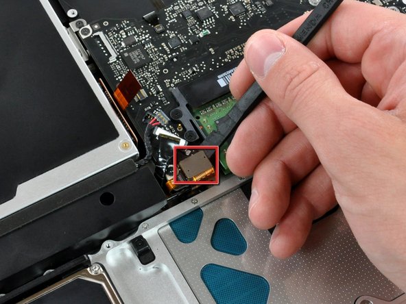

Add Note Edit Step 14  ¶
  • Use a spudger to pry the trackpad connector straight up off the logic board.
Image #1 Image #2

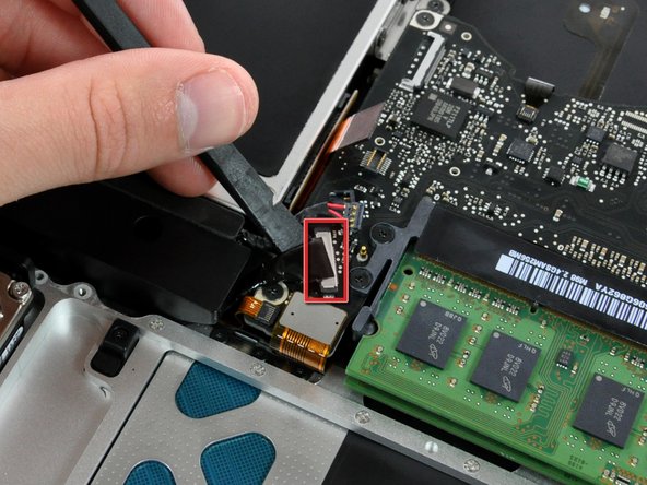

Add Note Edit Step 15  ¶
  • Using the tip of a spudger, flip up the IR/sleep LED ribbon cable retaining flap.
  • Pull the IR/sleep LED ribbon cable straight out of its socket.
Image #1
