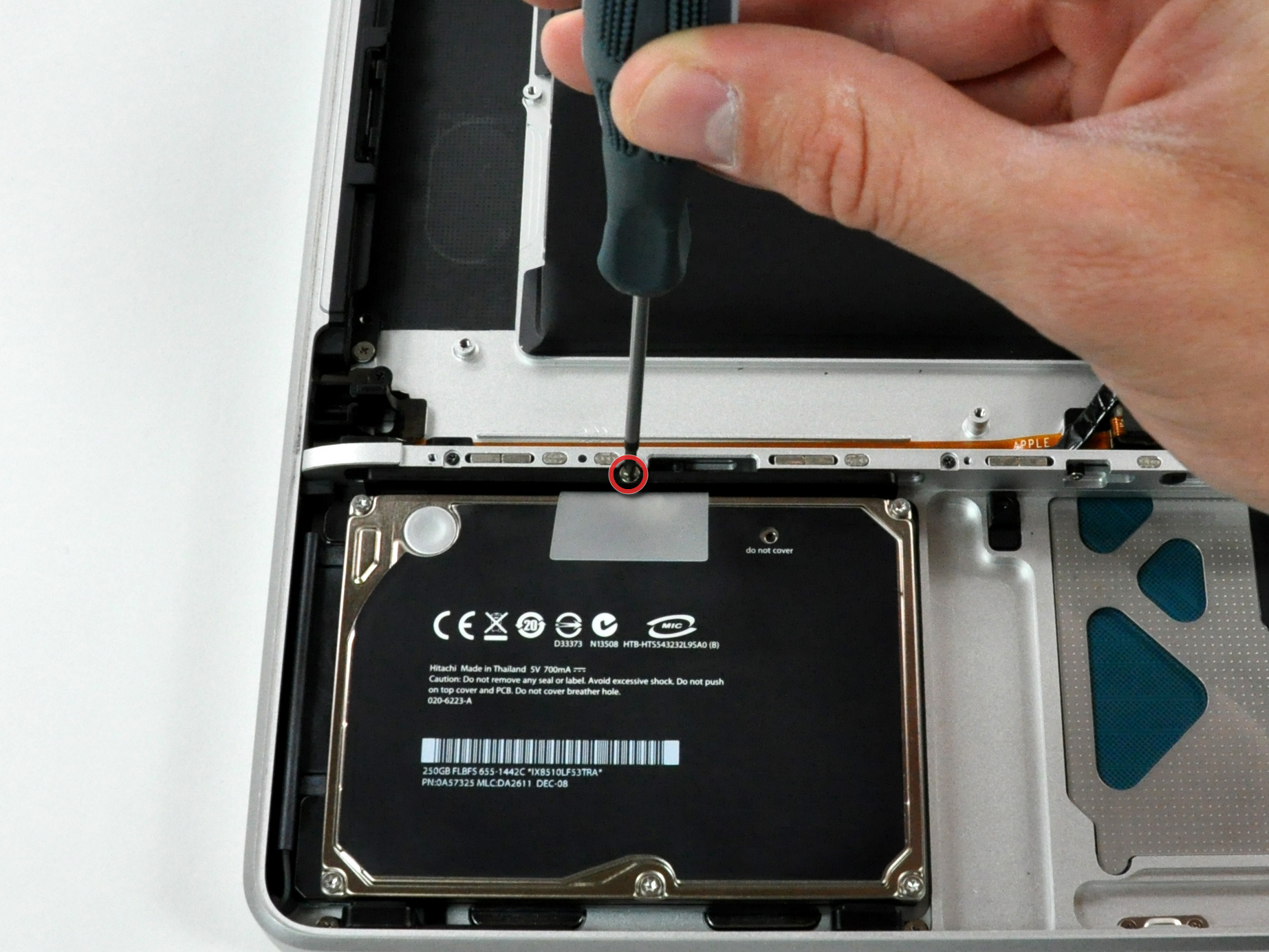

Add Note Edit Step 15 — Hard Drive Cable  ¶
  • Remove the single Phillips screw securing the hard drive bracket to the upper case.
  • This screw is captive in the hard drive bracket.
first image
Add Note Edit Step 16  ¶
  • Lift the hard drive by its plastic pull tab and remove the freed hard drive bracket.
first image
