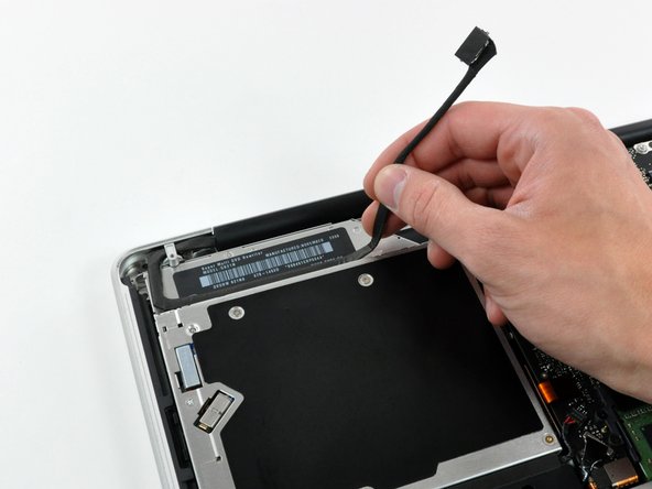

  6. Installing MacBook Pro 15" Unibody Late 2008 and Early 2009 Dual Hard Drive, Optical Drive: step 6, image 1 of 1
    • Disconnect the camera cable by pulling the male end straight away from its socket.
  7. Installing MacBook Pro 15" Unibody Late 2008 and Early 2009 Dual Hard Drive: step 7, image 1 of 1
    • Deroute the camera data cable from the channel in the optical drive.

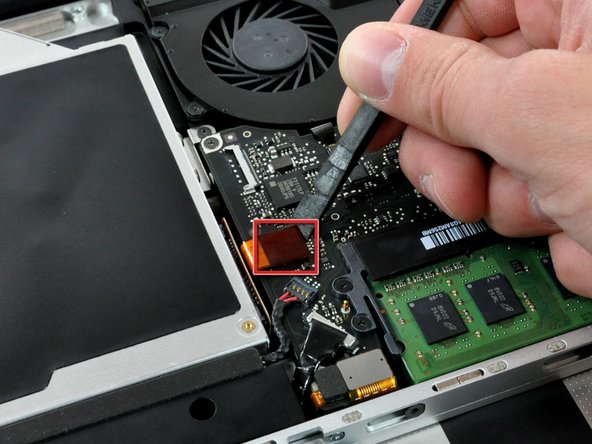

  8. Installing MacBook Pro 15" Unibody Late 2008 and Early 2009 Dual Hard Drive: step 8, image 1 of 1
    • Use a spudger to pry the optical drive connector straight up off the logic board.

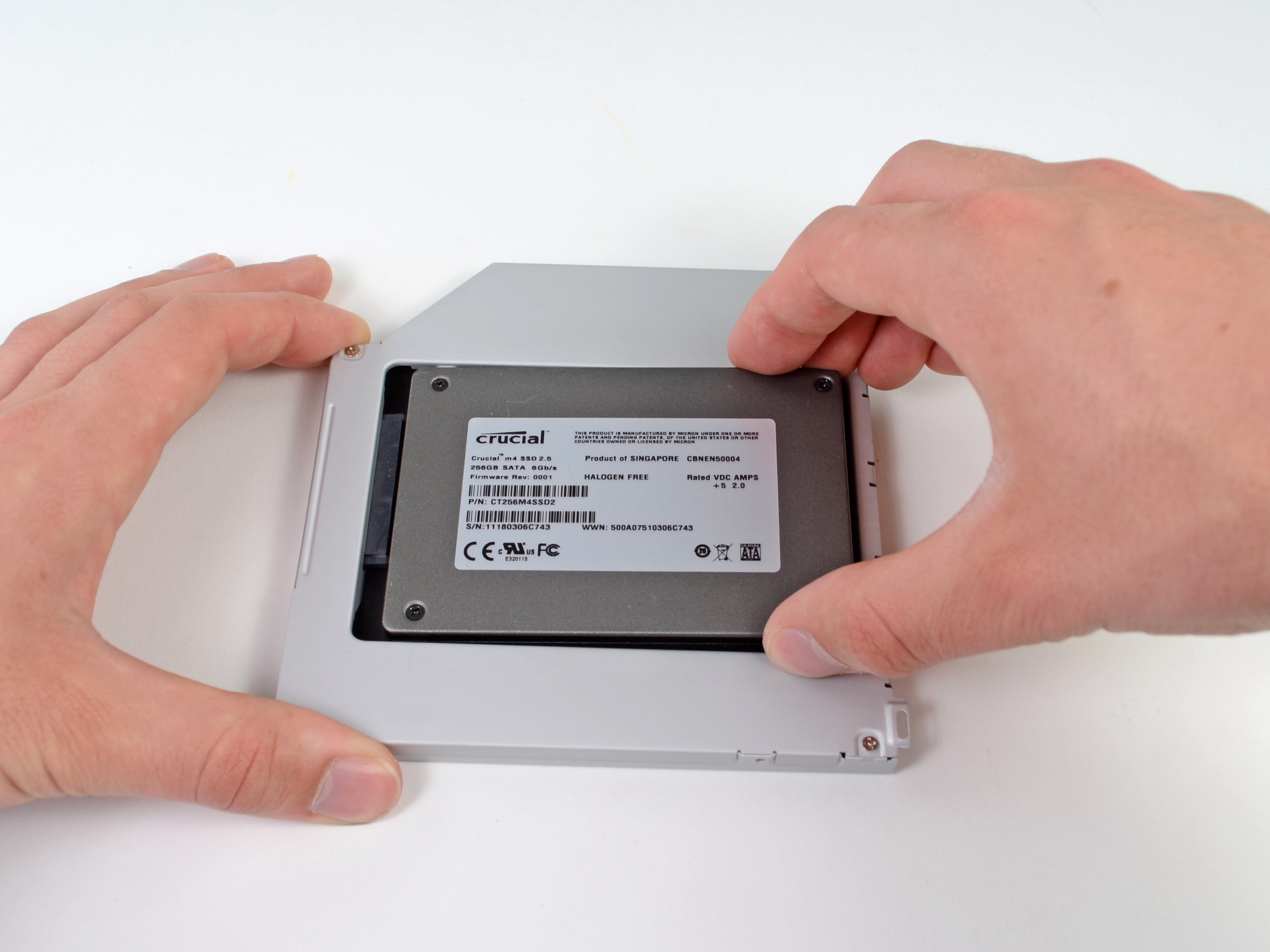

  15. Installing MacBook Pro 15" Unibody Late 2008 and Early 2009 Dual Hard Drive: step 15, image 1 of 3 Installing MacBook Pro 15" Unibody Late 2008 and Early 2009 Dual Hard Drive: step 15, image 2 of 3 Installing MacBook Pro 15" Unibody Late 2008 and Early 2009 Dual Hard Drive: step 15, image 3 of 3
    • Make sure that the hard drive connectors are facing down before placing it into the enclosure.
    • Gently place the hard drive into the enclosure's hard drive slot.
    • While firmly holding the enclosure in place with one hand, use your other hand to press the hard drive into the enclosure connectors.
