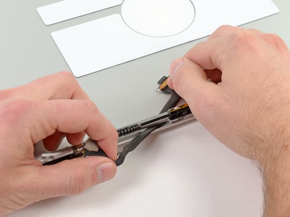

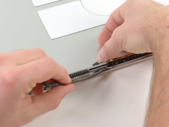

Add Note Edit Step 30 — Display Data Cable  ¶
  • Carefully pull the display data cable through the recess located near the left hinge.
  • Do not use excessive force to pull the cable through as it may damage the connector.
Image #1
Add Note Edit Step 31  ¶
  • Display data cable remains.
