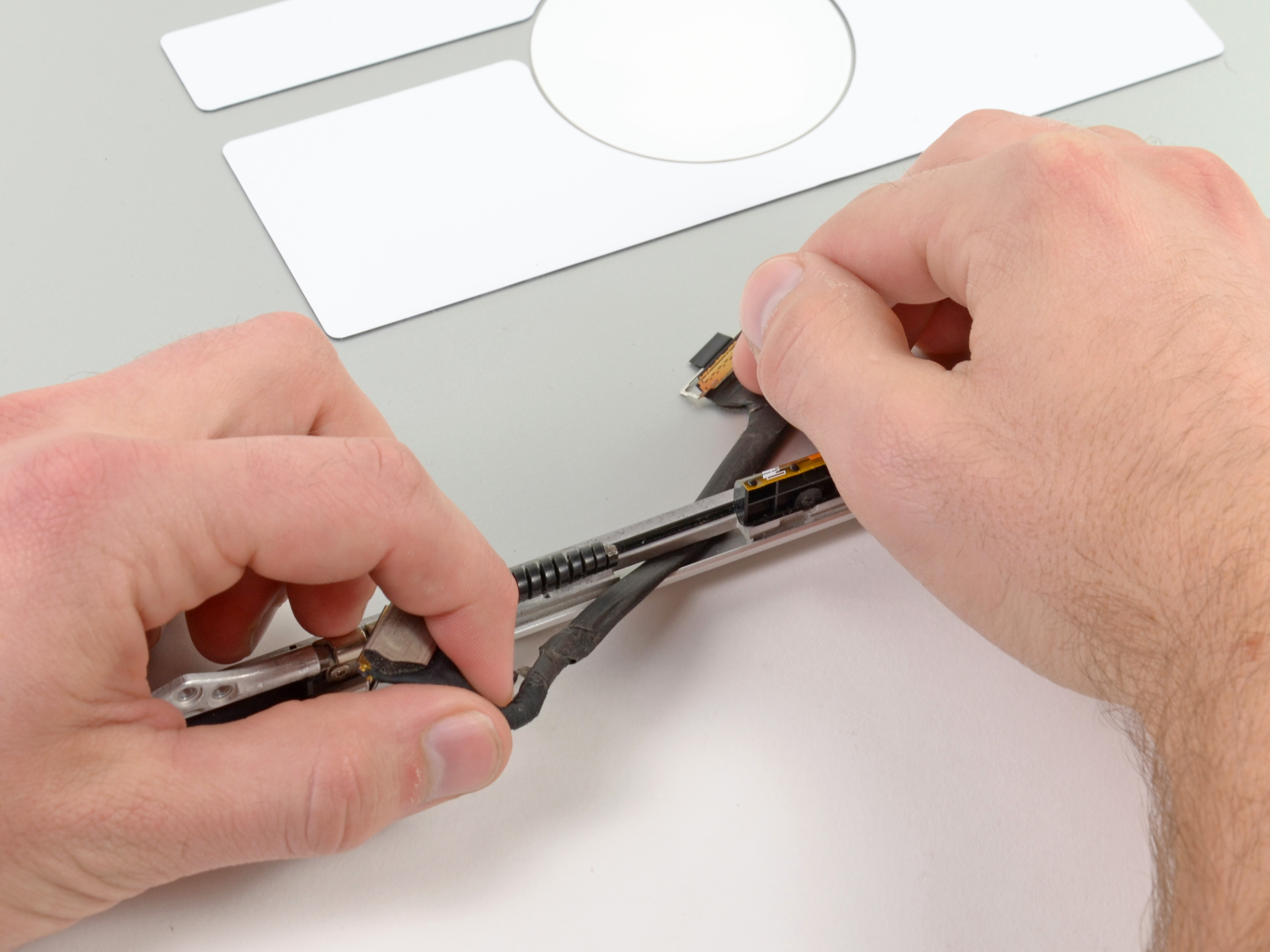

Image #1 Image #2 Image #3
Add Note Edit Step 23  ¶
  • During the glass removal process, the camera cable may stick to the adhesive on the glass panel, disconnecting it from the camera board as the panel is lifted. If your camera cable is still connected to the camera board, skip this step.
  • To reconnect the cable, first use the tip of a spudger to remove the piece of foam tape over the camera cable ZIF socket.
  • Use the tip of a spudger to flip up the ZIF cable retainer on the camera cable socket.
  • Insert the camera cable into its socket on the camera board and use the tip of a spudger to snap down the ZIF cable retainer, locking the cable in place.
  • Reapply the piece of tape covering the camera cable socket.
