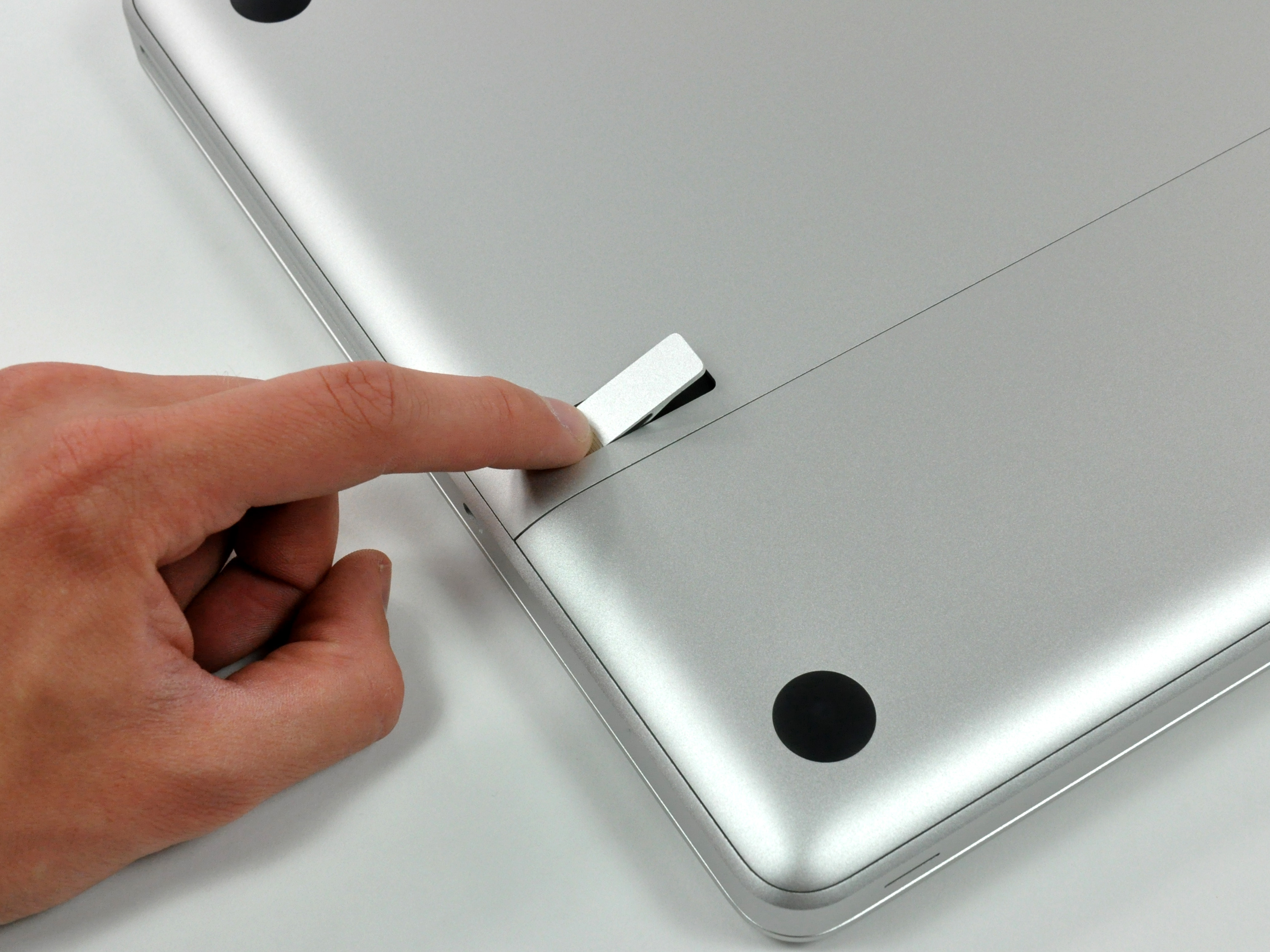

  • With the case closed, place the Unibody top-side down on a flat surface.
  • Depress the grooved side of the access door release latch enough to grab the free end. Lift the release latch until it is vertical.
first image
Add Note Edit Step 2  ¶
  • The access door should now be raised enough to lift it up and out of the Unibody.
