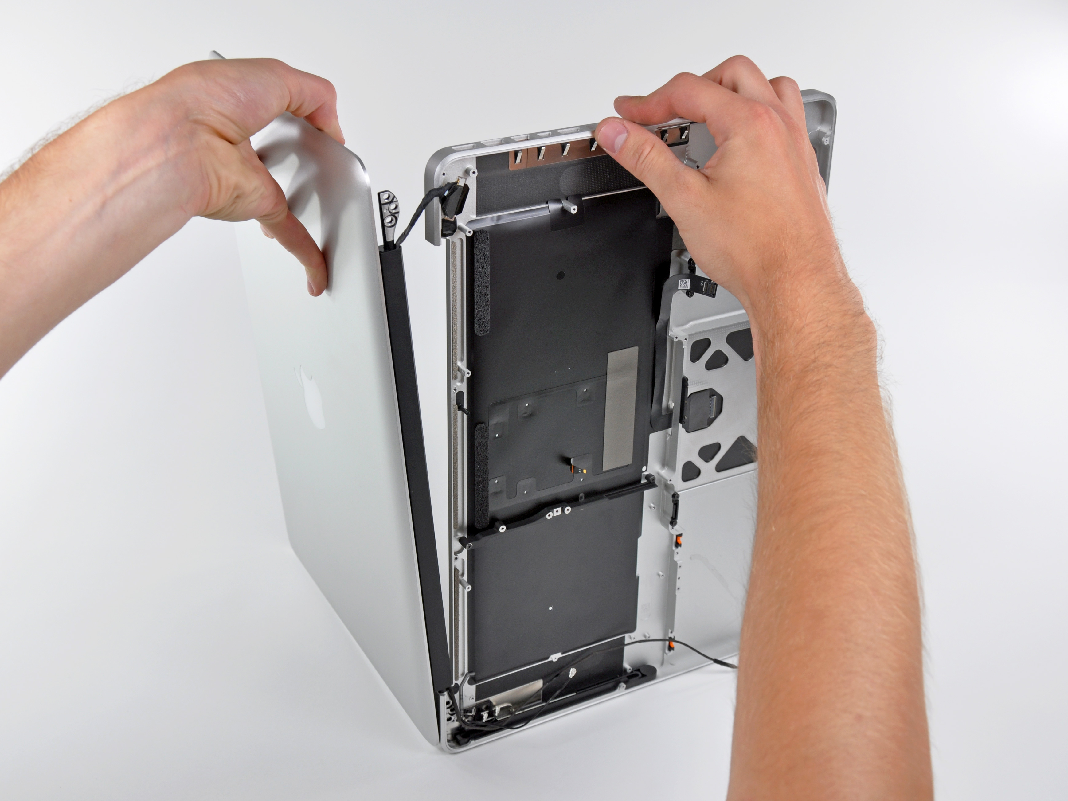

Add Note Edit Step 40  ¶
  • Open your MacBook Pro so the display is perpendicular to the upper case.
  • Place your opened MacBook Pro on a table as pictured.
  • While holding the display and upper case together with your left hand, remove the remaining T6 Torx screw from the upper display bracket.
first image
Add Note Edit Step 41  ¶
  • Be sure to hold the display and upper case together with your left hand. Failure to do so may cause the freed display/upper case to fall, potentially damaging each component.
  • Remove the last remaining T6 Torx screw securing the display to the upper case.
first image
thumb image 1
thumb image 2
thumb image 3
Add Note Edit Step 42  ¶
  • Grab the upper case with your right hand and rotate it slightly toward the top of the display so the upper display bracket clears the edge of the upper case.
  • Rotate the display slightly away from the upper case.
  • Lift the display up and away from the upper case, minding any brackets or cables that may get caught.
