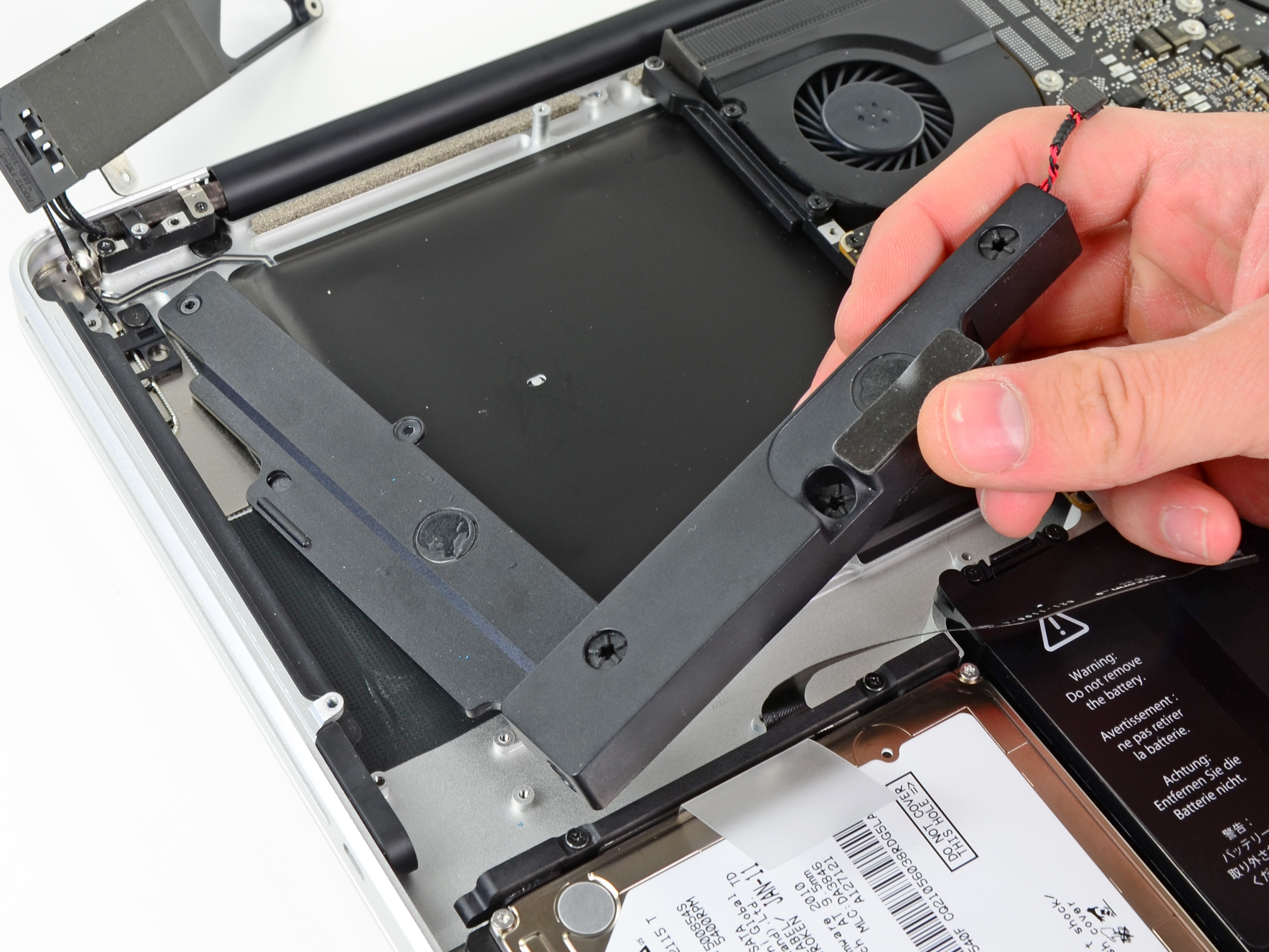

Has the right side of your MacBook Pro gone mute? Use this guide to replace the subwoofer & right speaker assembly.
Remove the following ten screws securing the lower case to the upper case:
Three 13.5 mm (14.1 mm) Phillips screws.
Seven 3 mm Phillips screws.
Use the edge of a spudger to pry the battery connector upwards from its socket on the logic board.
Use the flat end of a spudger to pry the hard drive/IR sensor cable connector up off the logic board.
Peel the hard drive cable up from the channel within the subwoofer and right speaker.
