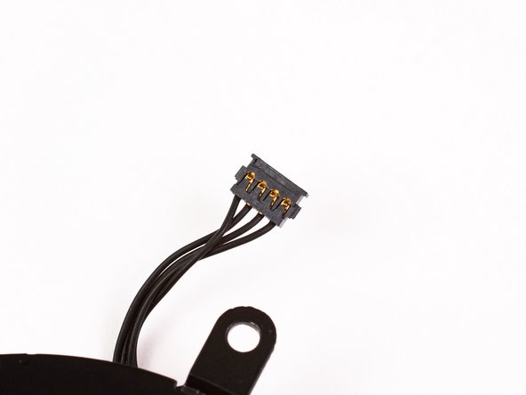

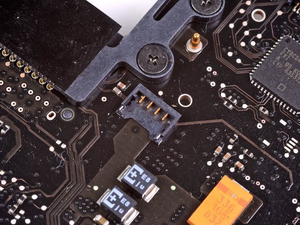

  5. MacBook Pro 15" Unibody Early 2011 Right Fan Replacement, Right Fan: step 5, image 1 of 3 MacBook Pro 15" Unibody Early 2011 Right Fan Replacement, Right Fan: step 5, image 2 of 3 MacBook Pro 15" Unibody Early 2011 Right Fan Replacement, Right Fan: step 5, image 3 of 3

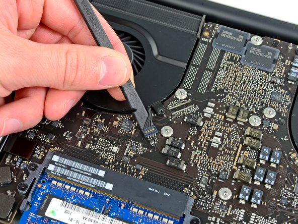

    • Use a spudger to pry the fan connector straight up off the logic board.
    • It is useful to twist the spudger axially from beneath the fan cable wires to release the connector.
    • The fan socket and the fan connector can be seen in the second and third pictures. Be careful not to break the plastic fan socket off the logic board as you use your spudger to lift the fan connector straight up and out of its socket. The layout of the logic board shown in the second picture may look slightly different than your machine but the fan socket is the same.

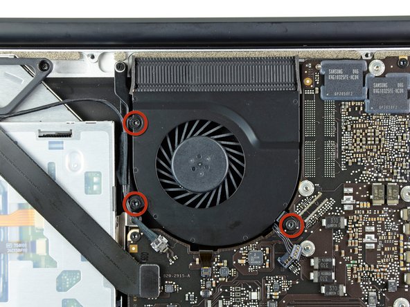

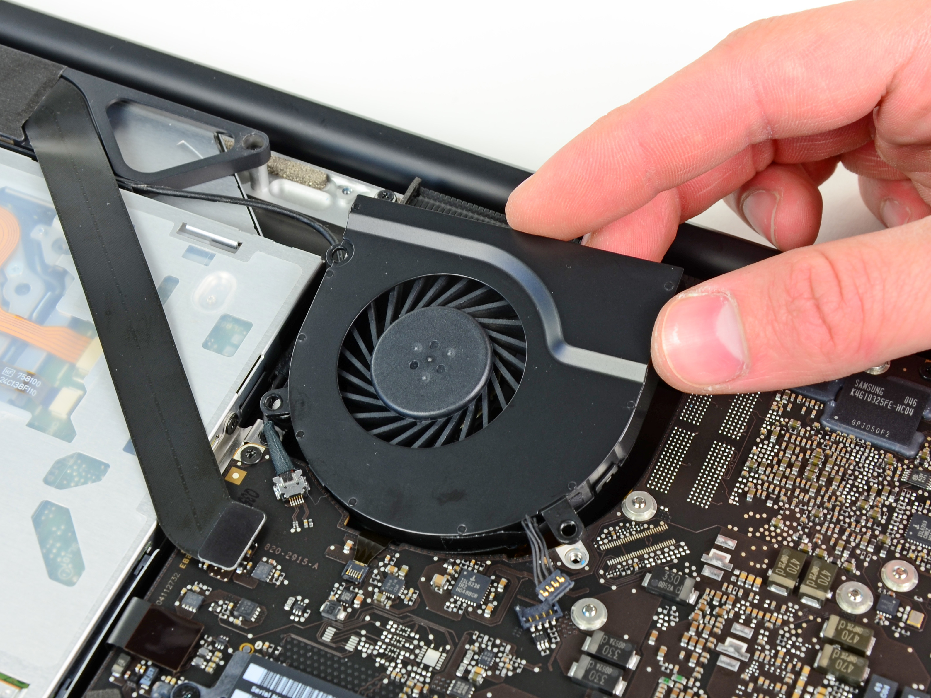

    • Remove three T6 Torx screws securing the right fan to the logic board and upper case.
  7. MacBook Pro 15" Unibody Early 2011 Right Fan Replacement: step 7, image 1 of 1
    • Lift the right fan out of the upper case.
