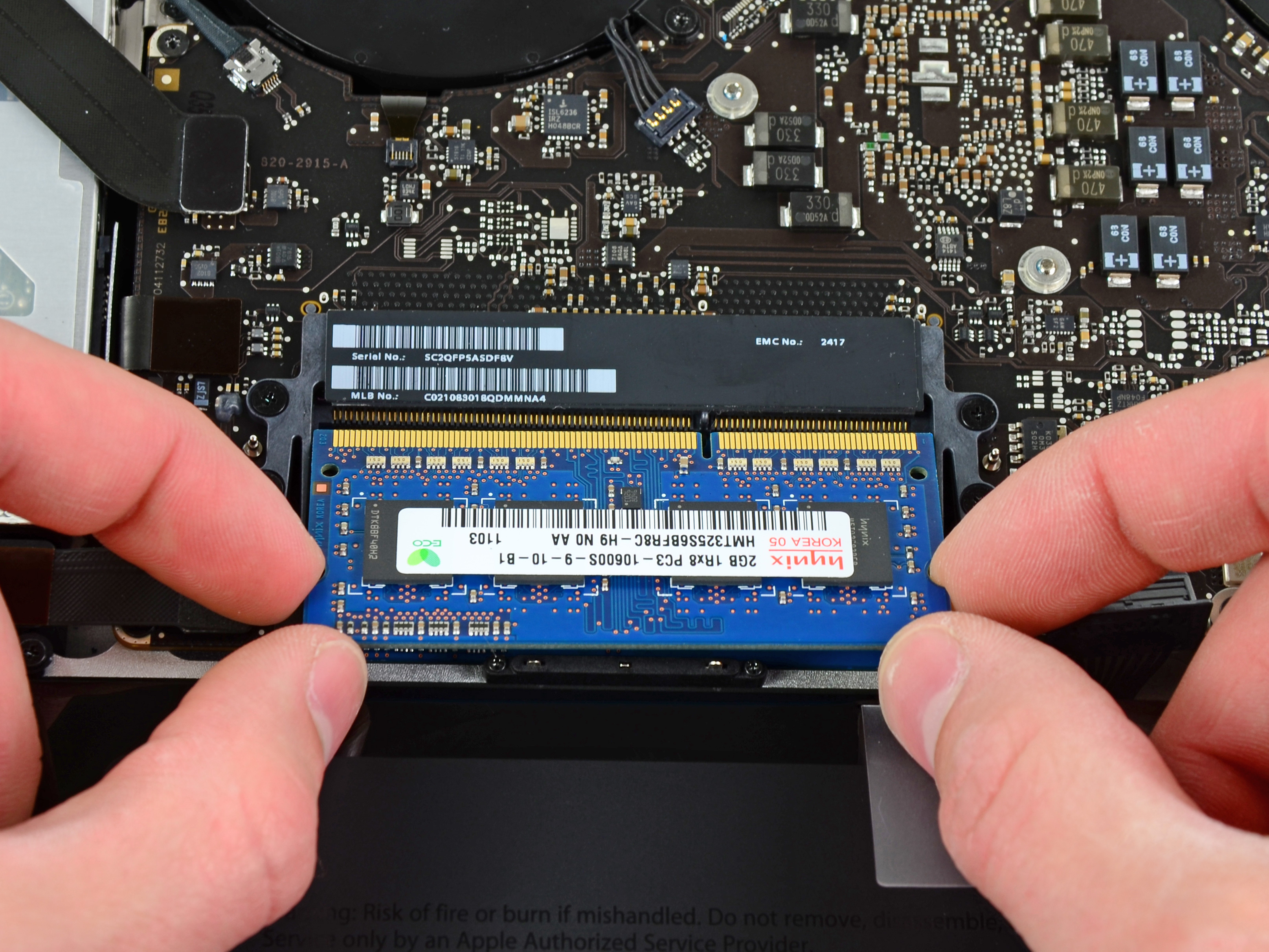

  5. MacBook Pro 15" Unibody Early 2011 RAM Replacement, RAM: step 5, image 1 of 3 MacBook Pro 15" Unibody Early 2011 RAM Replacement, RAM: step 5, image 2 of 3 MacBook Pro 15" Unibody Early 2011 RAM Replacement, RAM: step 5, image 3 of 3
    • Release the tabs on each side of the RAM chip by simultaneously pushing each tab away from the RAM module.
    • These tabs lock the chip in place and releasing them will cause the chip to "pop" up.
    • After the RAM chip has popped up, pull it straight out of its socket.
    • Repeat this process if a second RAM chip is installed.
