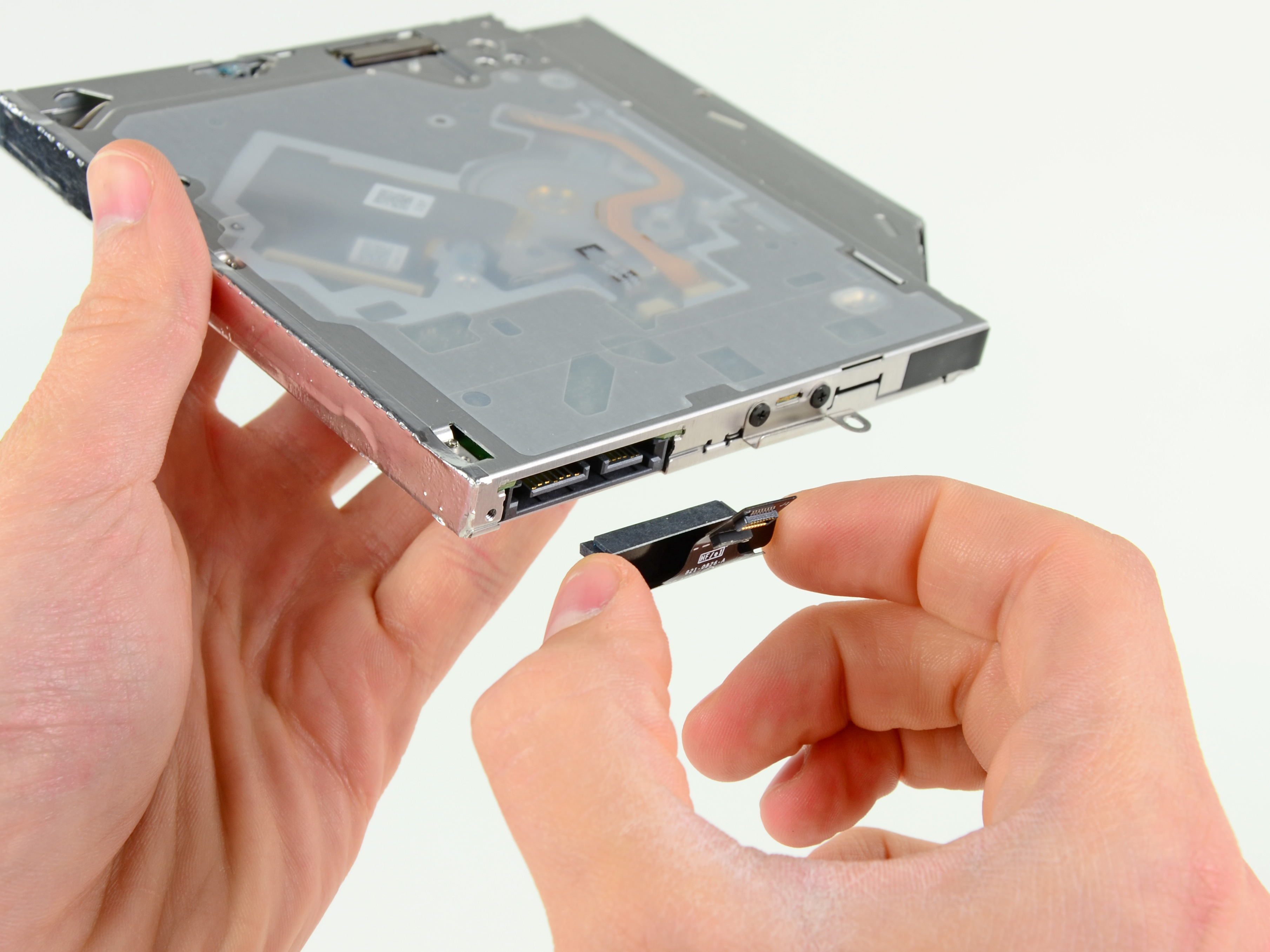

Add Note Edit Step 11 — Optical Drive Cable  ¶
  • Pull the optical drive cable out of the optical drive.
  • Be sure to pull by the edges of the connector, not by the cable itself.
