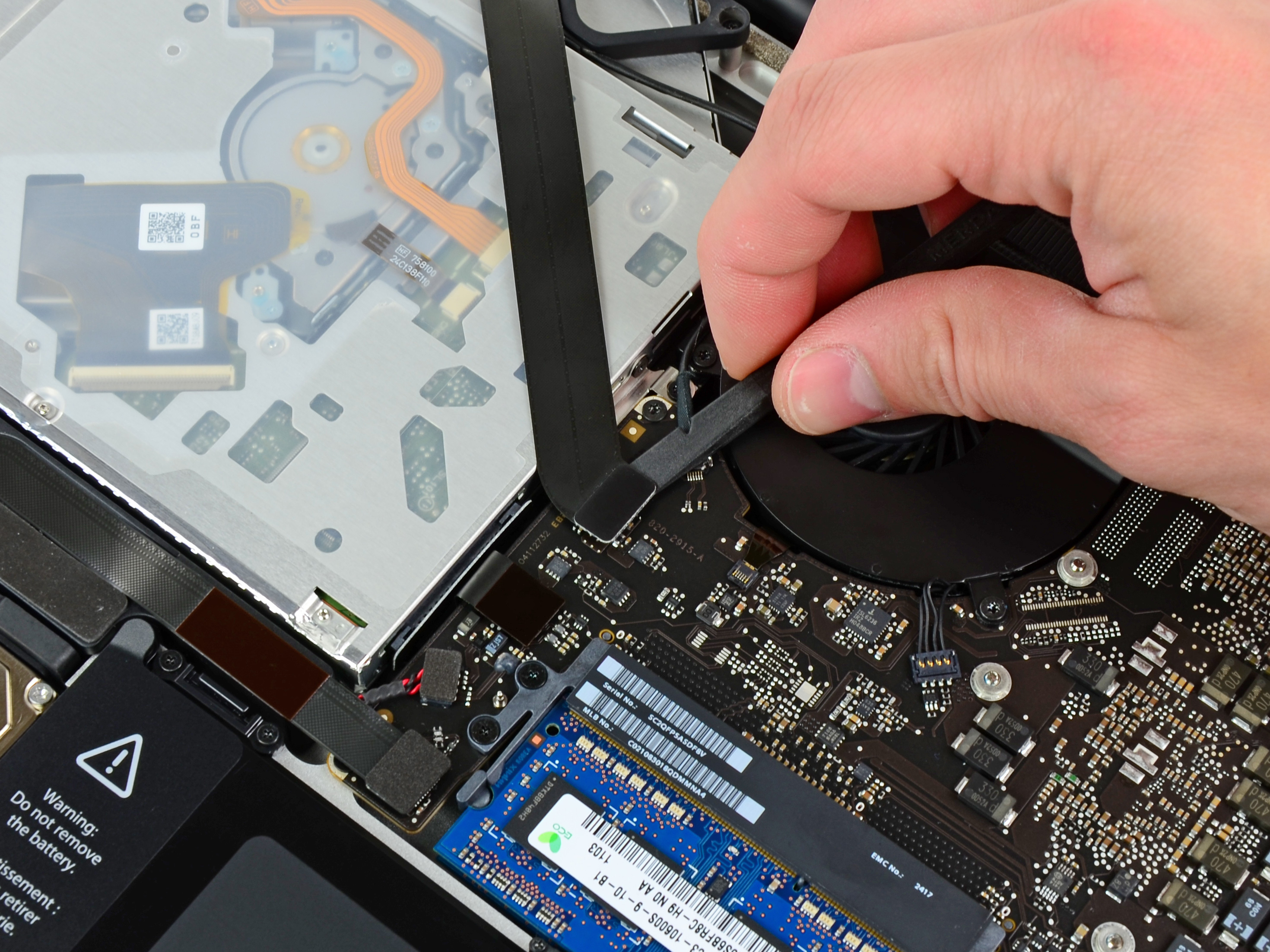

    • Use the flat end of a spudger to lift the right fan connector out of its socket on the logic board.
    • It is useful to twist the spudger axially from beneath the fan cable wires to release the connector.
