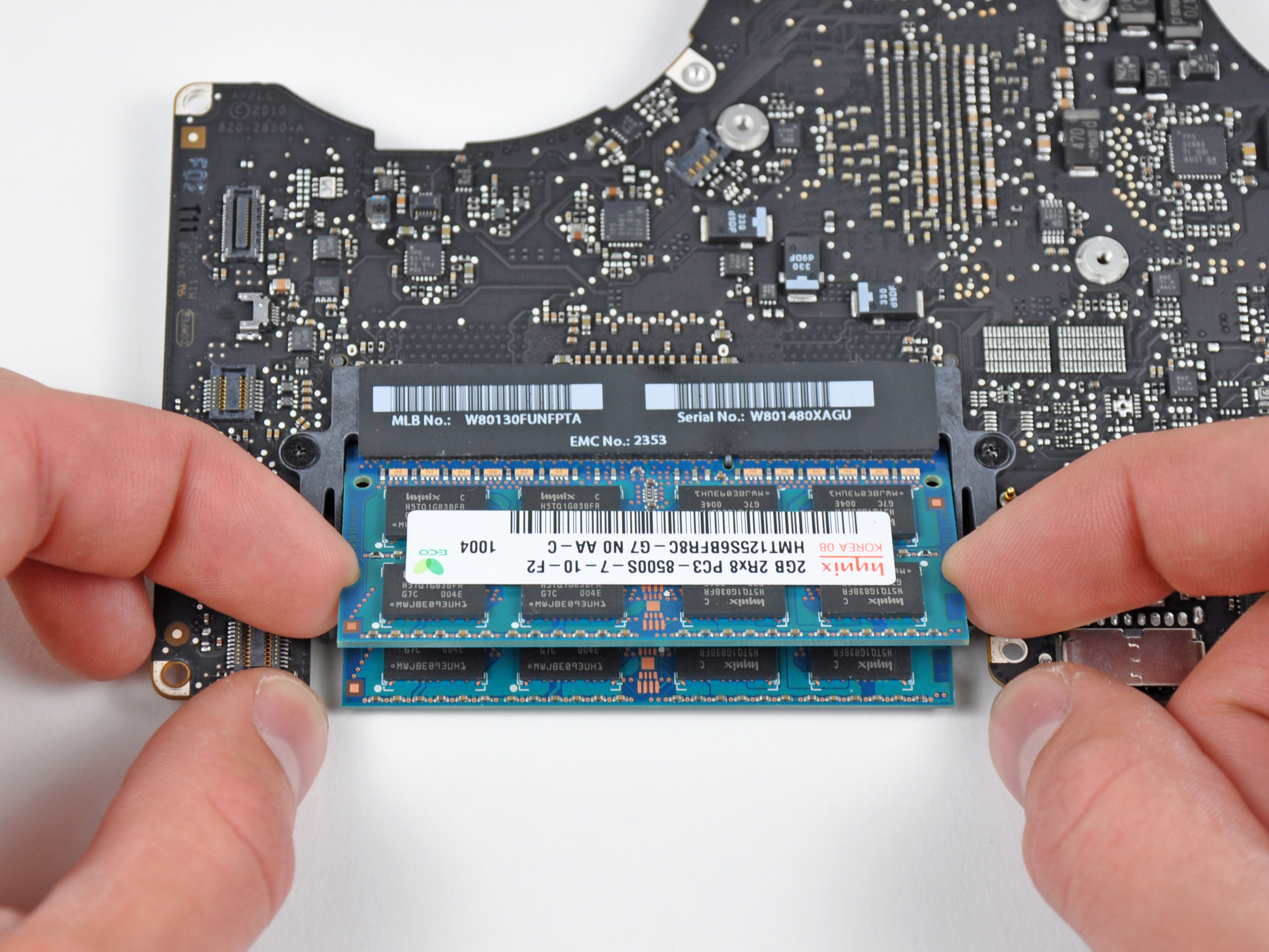

  33. MacBook Pro 15" Unibody Early 2011 Logic Board Replacement: step 33, image 1 of 2 MacBook Pro 15" Unibody Early 2011 Logic Board Replacement: step 33, image 2 of 2
    • Release the tabs on each side of the RAM chip by simultaneously pushing each tab away from the RAM.
    • These tabs lock the chip in place and releasing them will cause the chip to "pop" up.
    • After the RAM chip has popped up, pull it straight out of its socket.
    • Repeat this process if a second RAM chip is installed.
    • Logic board remains.
    • If you need to mount the heat sink back onto the logic board, we have a thermal paste guide that makes replacing the thermal compound easy.
