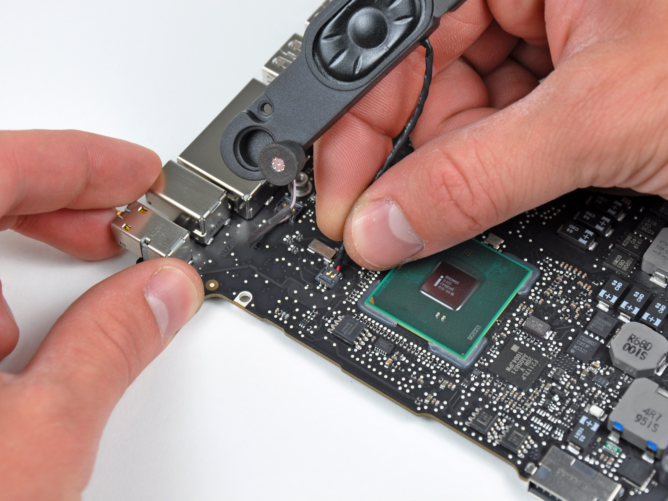

  23. MacBook Pro 15" Unibody Early 2011 Left Speaker Replacement, Left Speaker: step 23, image 1 of 1
    • Lift the microphone out of its recess in the left speaker housing.
  24. MacBook Pro 15" Unibody Early 2011 Left Speaker Replacement: step 24, image 1 of 1
    • Remove the two 5 mm Phillips screws securing the left speaker to the logic board.
  25. MacBook Pro 15" Unibody Early 2011 Left Speaker Replacement: step 25, image 1 of 1
    • If present, remove the small strip of black tape covering the left speaker connector.
    • Carefully pull the left speaker wires upward to lift the left speaker connector out of its socket on the logic board.
