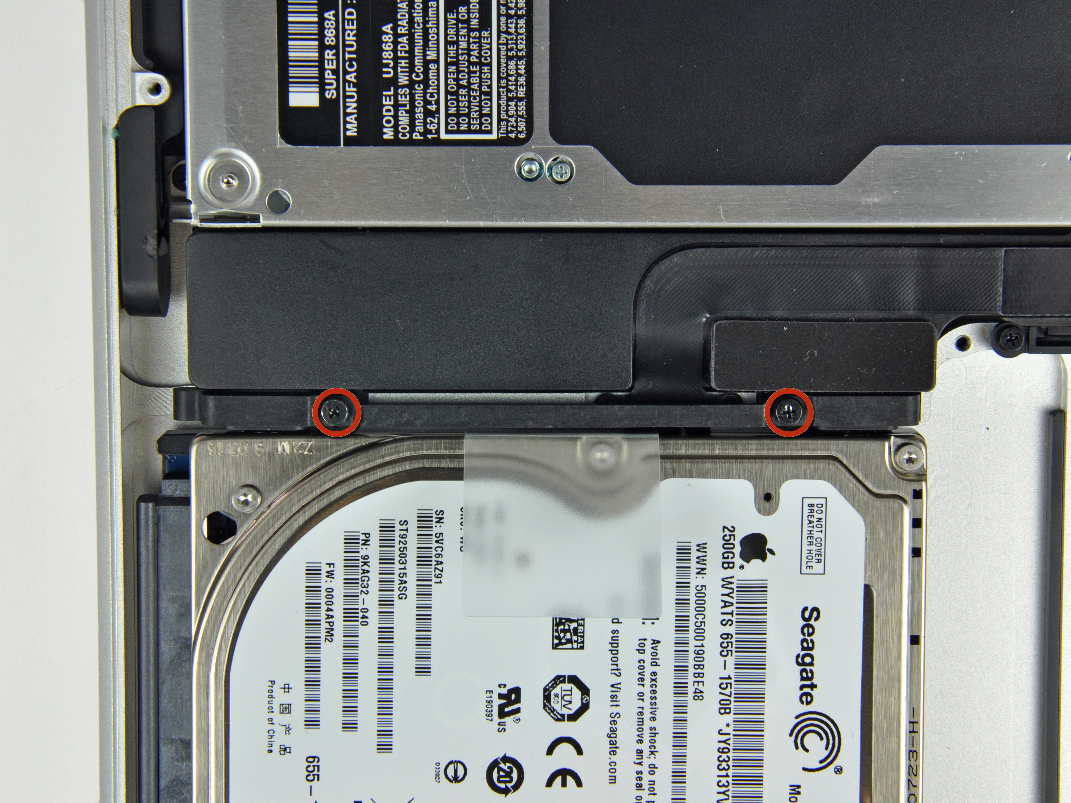

  • Remove the two exposed five-point Pentalobe screws along the top edge of the battery.
Image #1
