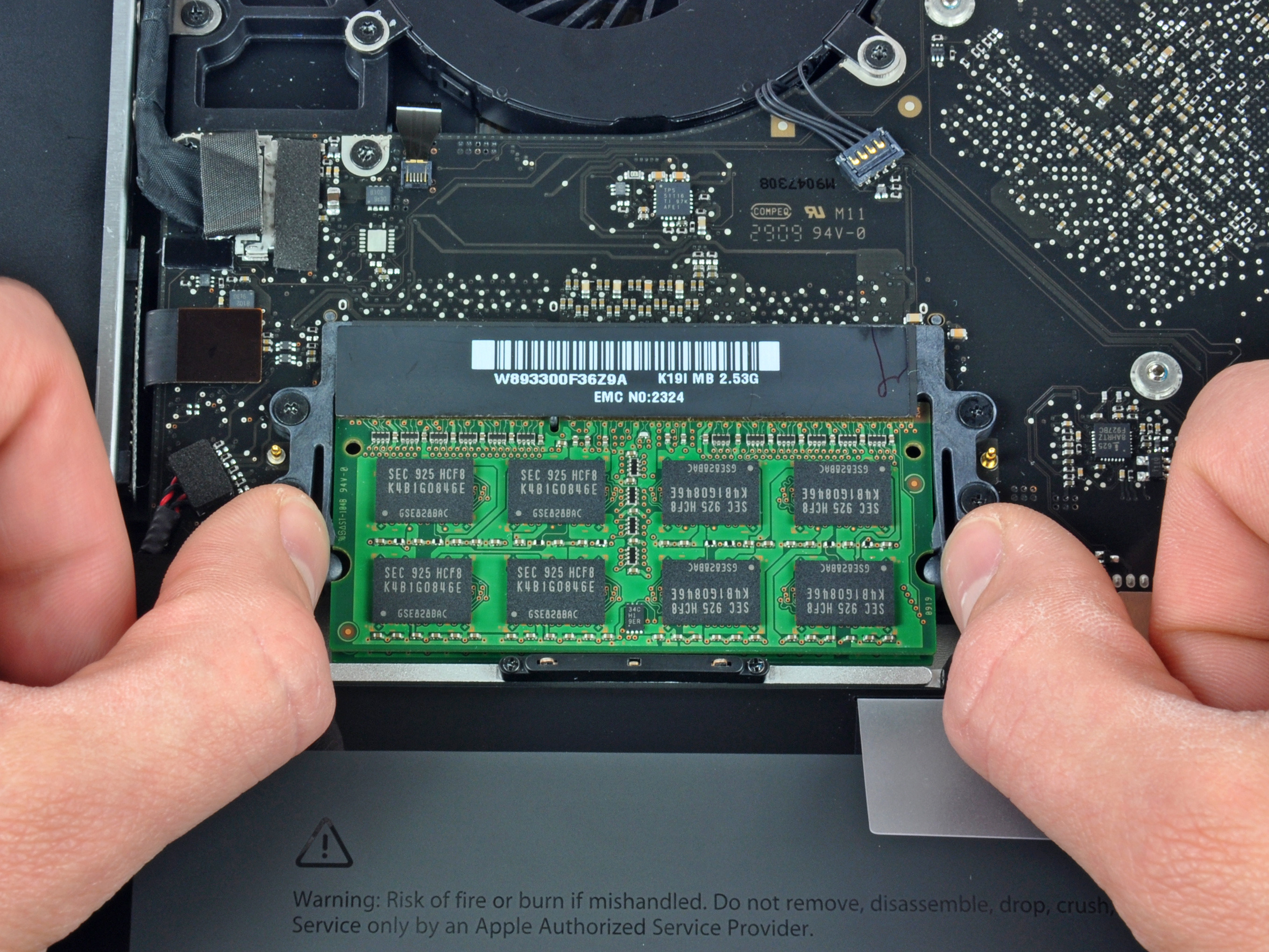

Add Note Edit Step 3 — RAM  ¶
  • Release the tabs on each side of the chip by simultaneously pushing each tab away from the RAM.
  • These tabs lock the chip in place and releasing them will cause the chip to "pop" up.
  • After the RAM chip has popped up, pull it straight out of its socket.
  • Repeat this process if a second RAM chip is installed.
