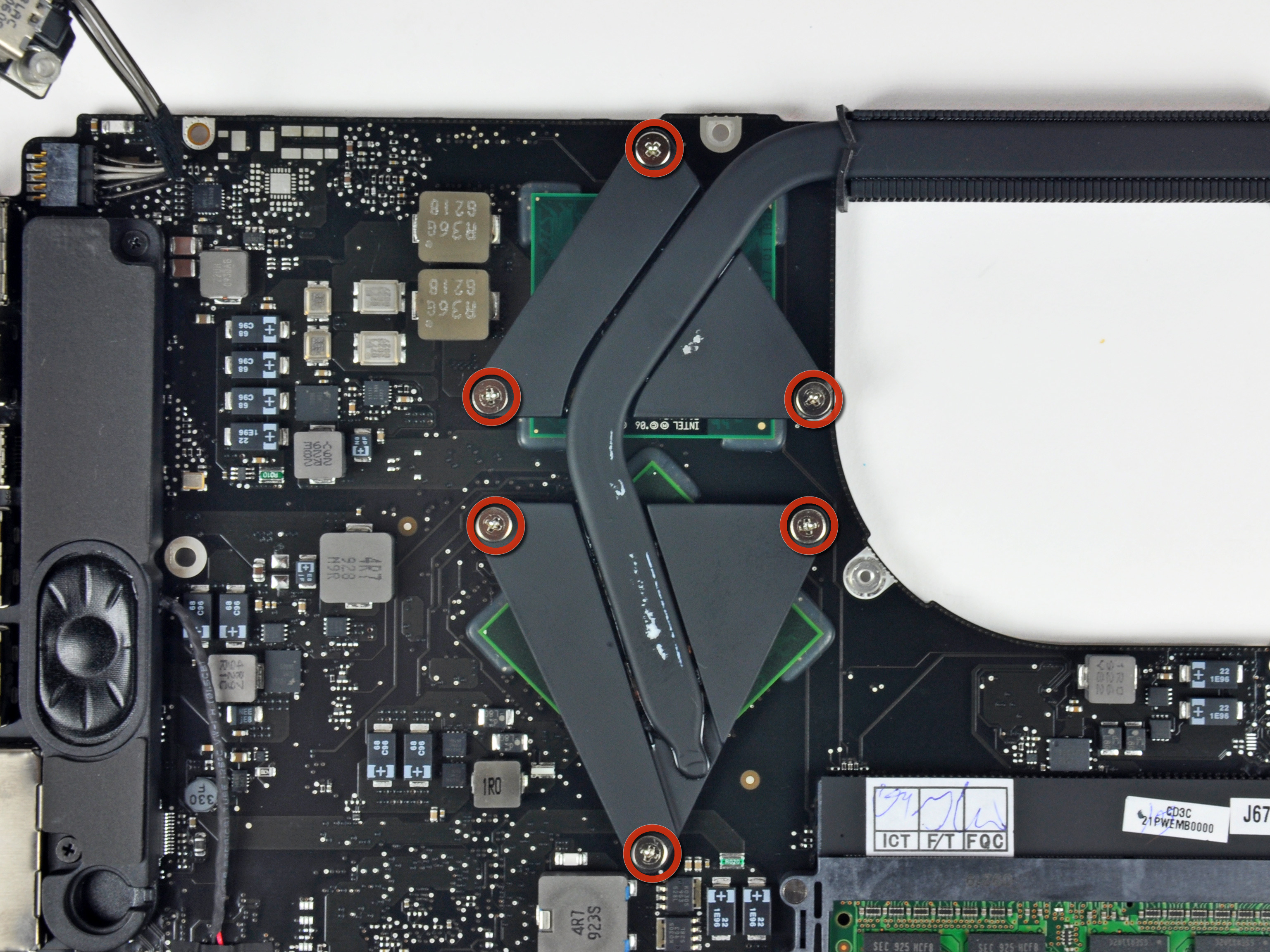

Use this guide to replace the heat sink or to reapply thermal paste to the processors.
Image #1
    • Seven 3 mm Phillips screws.

  • Tilt the battery back enough to access the battery cable connector.
  • Pull the battery cable connector away from its socket on the logic board and remove the battery from the upper case.
Image #1 Image #2 Image #3
Add Note Edit Step 8 — Fan  ¶
  • Use the flat end of a spudger to pry the fan cable connector up off its socket on the logic board.
  • It is useful to twist the spudger axially from beneath the fan cable wires to release the connector.
  • The fan socket and the fan connector can be seen in the second and third pictures. Be careful not to break the plastic fan socket off the logic board as you use your spudger to lift the fan connector straight up and out of its socket. The layout of the logic board shown in the second picture may look slightly different than your machine but the fan socket is the same.
