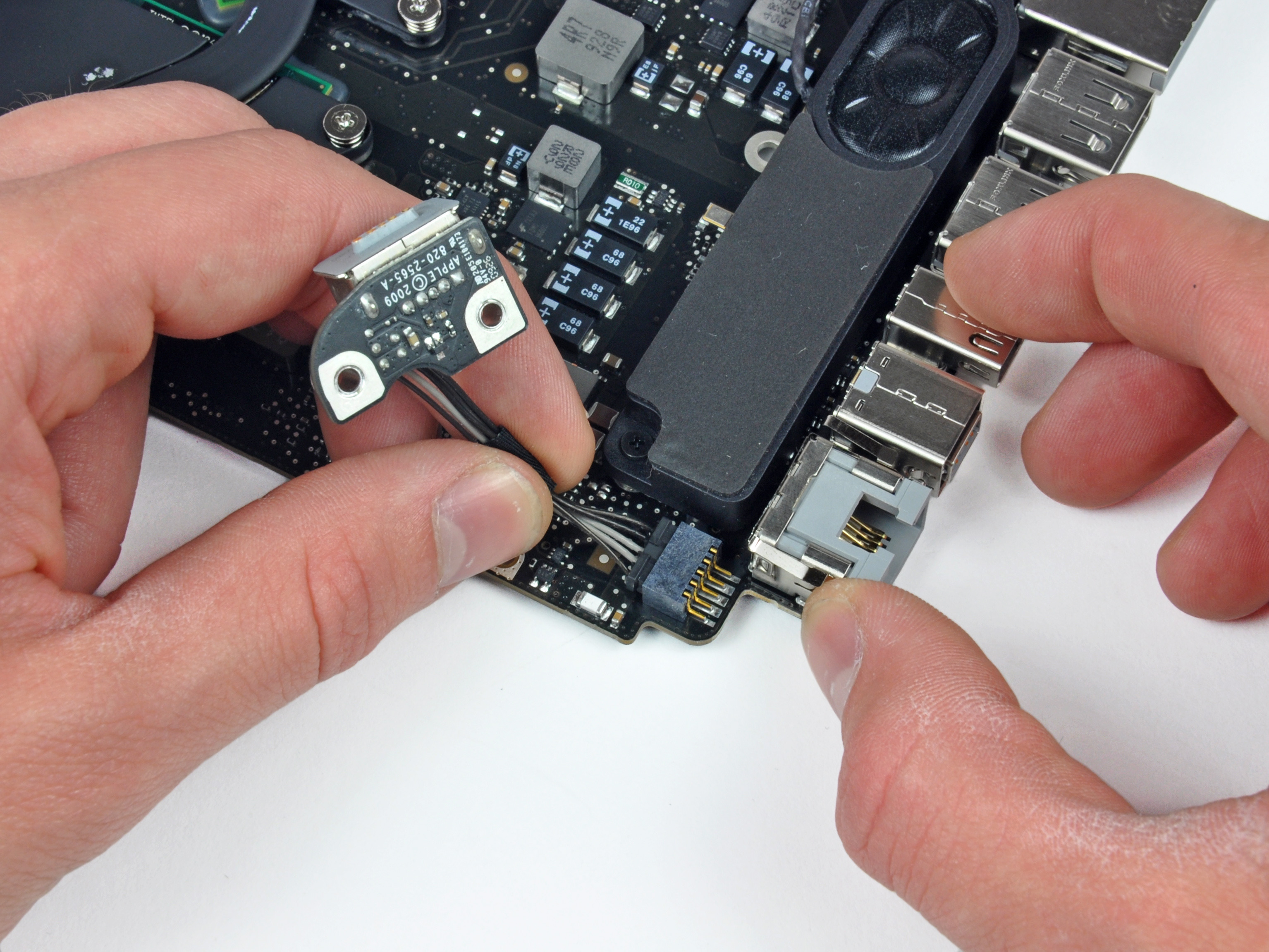

Installing MacBook Pro 15" Unibody 2.53 GHz Mid 2009 DC-In Board
- Author: Walter Galan
- Difficulty: Difficult
No power to the laptop? Replace the DC-In Board.
Sections
- Lower Case 2 steps
- Battery 5 steps
- Fan 3 steps
- Logic Board 15 steps
- DC-In Board 1 step
