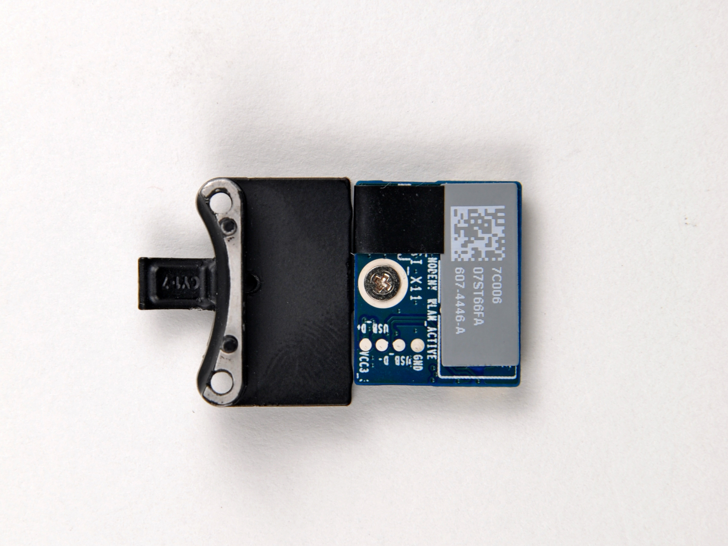

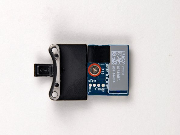

Step 3
Bluetooth Board (Anti-Glare Option)
Disconnect the Bluetooth cable by pulling the male end straight away from its socket.
Pull the connector parallel to the face of the logic board, not straight up.
Use the flat end of a spudger to pry the Bluetooth antenna cable from its socket on the board.
Edit
Step 4
Remove the two 8 mm Phillips screws securing the Bluetooth/camera cable retainer to the upper case.
One of the screws may remain captive in the Bluetooth/camera cable ground loop. If replacing the display, be sure to transfer this screw to the new unit.
Lift the Bluetooth board/cable retainer assembly out of the upper case.
