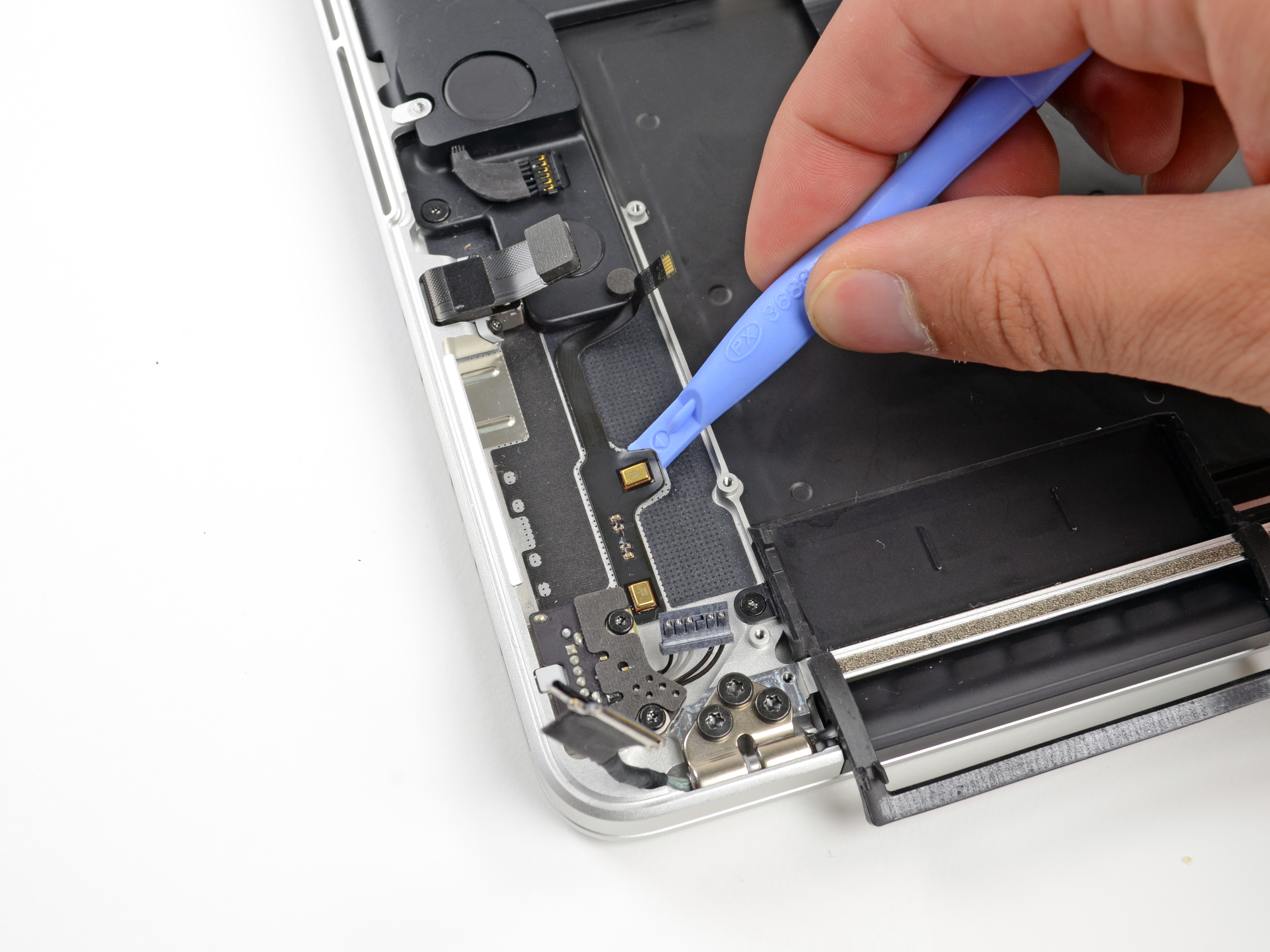

Installing MacBook Pro 15" Retina Display Mid 2012 Microphone
Replace the microphone in your MacBook Pro 15" Retina Display Mid 2012.
This guide will help you replace the microphone.
Image #1
  • Remove the following pentalobe screws securing the lower case to the MacBook Pro with Retina display.
    • Eight 3.0 mm
    • Two 2.3 mm
Image #1
Add Note Edit Step 2  ¶
  • Lifting from the edge nearest the clutch cover, lift the lower case off the MacBook Pro.
  • Set the lower case aside.
Image #1
Add Note Edit Step 3 — Battery Connector  ¶
  • Peel back the warning label covering the battery connector.
Image #1 Image #2
Add Note Edit Step 4  ¶
  • Using the flat end of a spudger, gently pry the battery connector straight up out of its socket on the logic board.
  • Bend the battery cables back and out of the way, ensuring that the battery connector doesn't accidentally make contact with the logic board.
Image #1 Image #2 Image #3
Add Note Edit Step 5 — I/O Board Cable  ¶
  • Using the flat end of a spudger, pry the I/O Board connector straight up out of its socket on the logic board.
  • In a similar fashion, remove the I/O Board connector from its socket on the I/O Board.
  • Remove the I/O Board cable from the MacBook Pro.
Image #1
Add Note Edit Step 6 — Right Fan  ¶
  • Remove the single 2.9 mm T5 Torx screw securing the AirPort card to the logic board.
Image #1 Image #2
Add Note Edit Step 7  ¶
  • Grasp the side of the AirPort card and pull parallel to the logic board, removing the AirPort card from the MacBook Pro.
Image #1 Image #2
Add Note Edit Step 8  ¶
  • Use the tip of a spudger to flip up the retaining flap on the right fan ribbon cable ZIF socket.
  • Gently pry up the right fan ribbon cable from the logic board.
