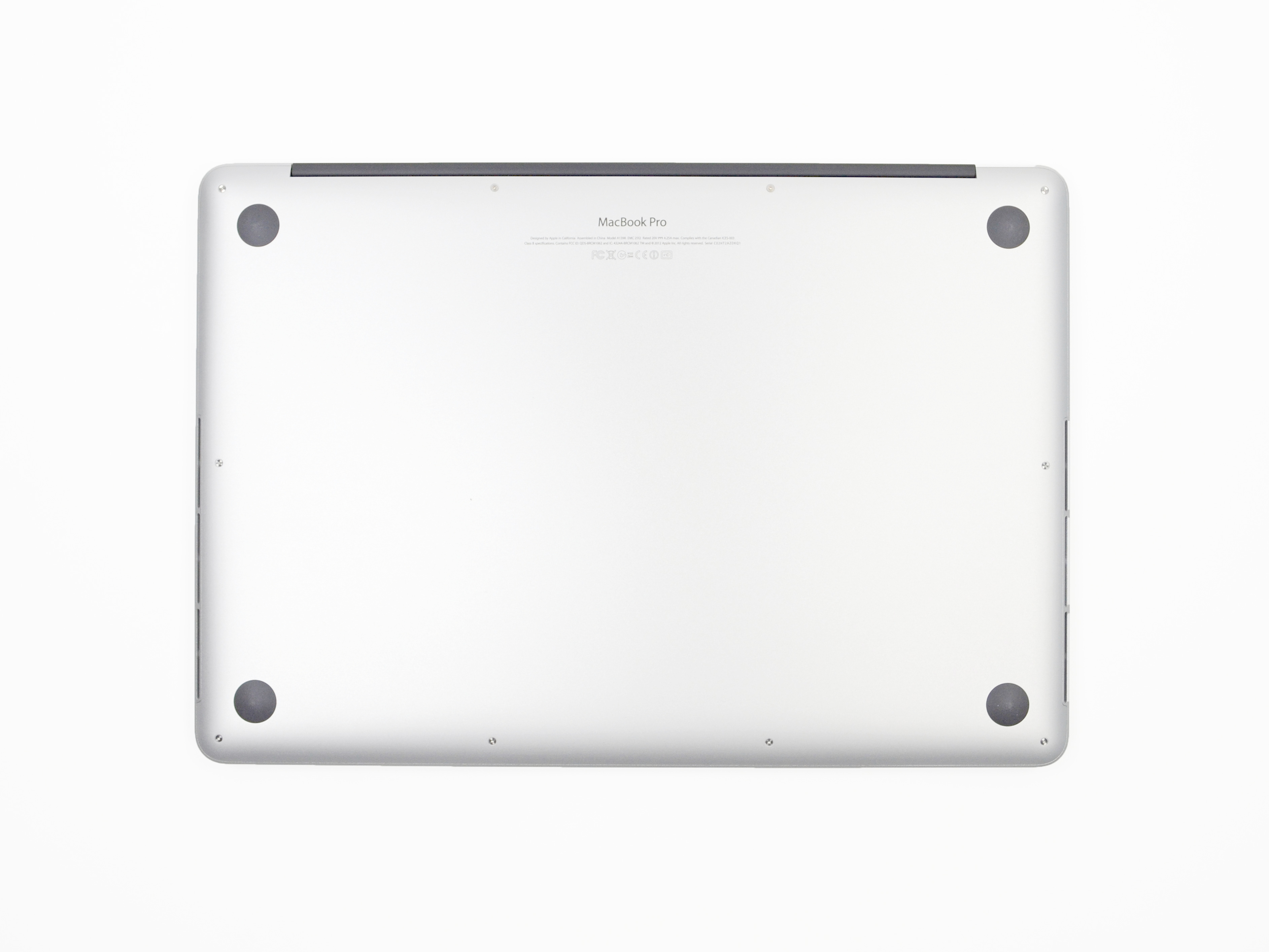

  • Remove the following pentalobe screws securing the lower case to the MacBook Pro with Retina display.
    • Eight 3.0 mm
    • Two 2.3 mm
Image #1
Add Note Edit Step 2  ¶
  • Lifting from the edge nearest the clutch cover, lift the lower case off the MacBook Pro.
  • Set the lower case aside.
