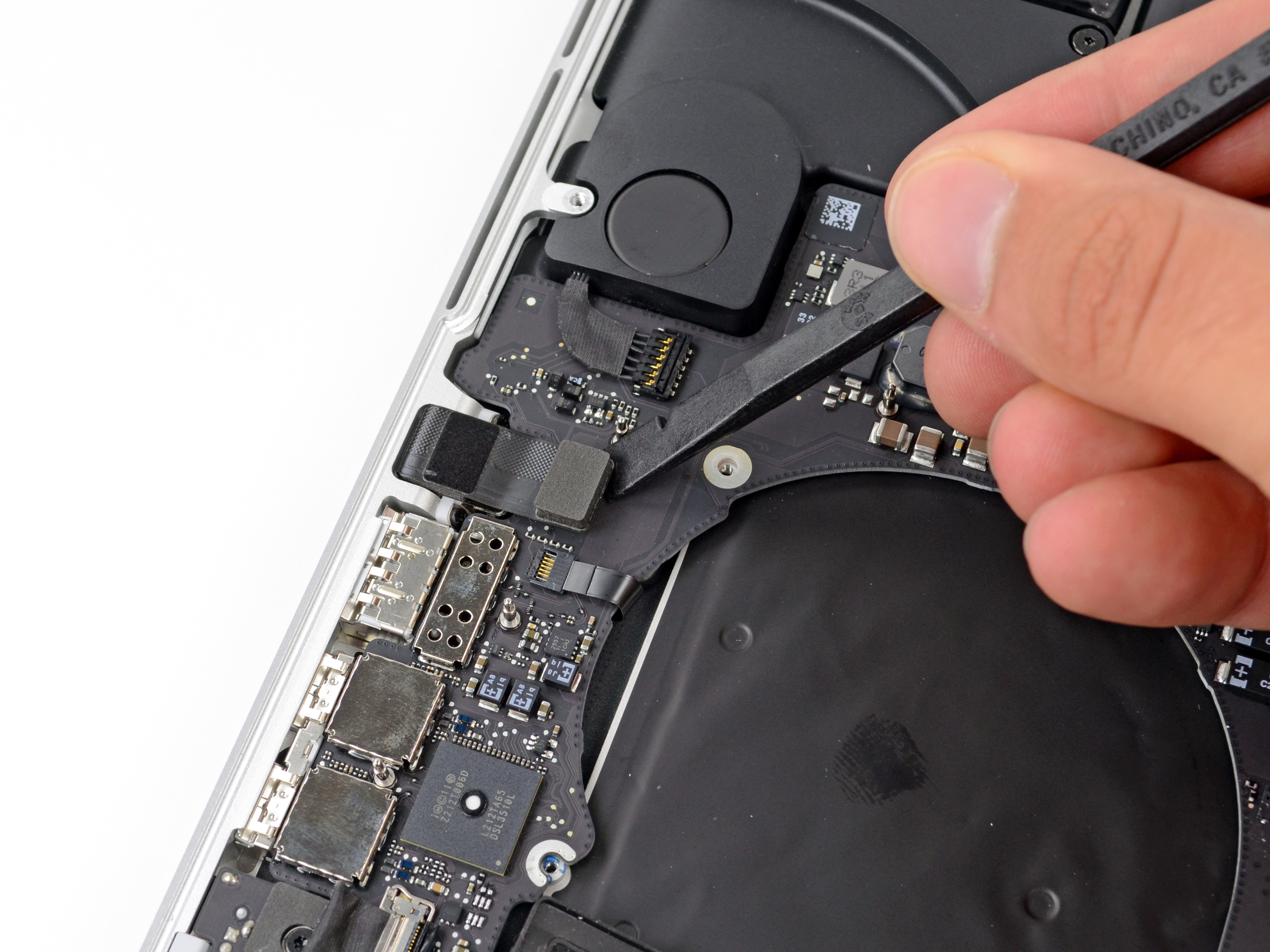

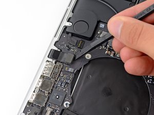

Add Note Edit Step 7  ¶
  • Use the tip of a spudger to pry the display data cable lock and rotate it toward the DC-In side of the computer.
  • Pull the display data cable straight out of its socket on the logic board.
  • Do not lift up on the display data cable, as its socket is very fragile. Pull the cable parallel to the face of the logic board.
