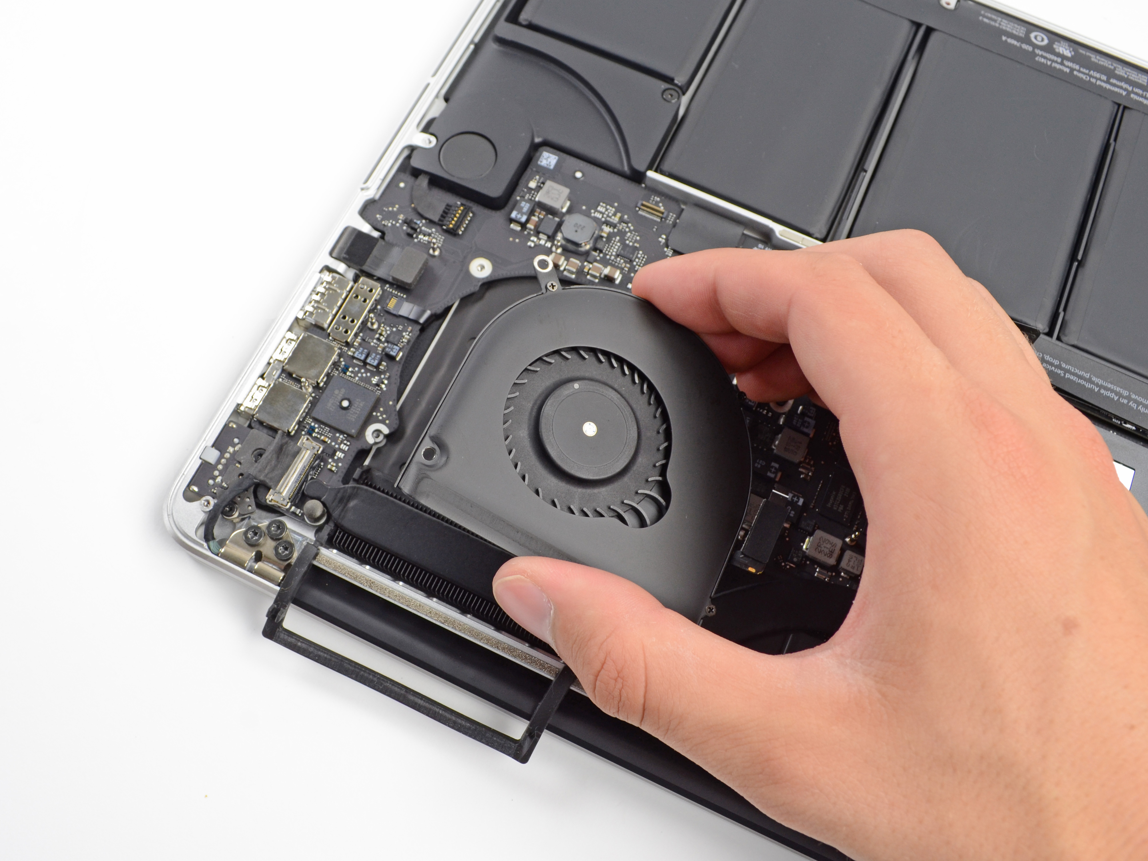

Add Note Edit Step 5 — Left Fan  ¶
  • Use the flat end of a spudger to lift the rubber heat sink cover up off the left fan.
Image #1
Add Note Edit Step 6  ¶
  • Remove the following three screws securing the left fan to the logic board:
    • One 4.4 mm T5 Torx screw
    • One 5.0 mm T5 Torx screw
    • One 3.9 mm T5 Wide Head Torx screw
Image #1 Image #2 Image #3
Add Note Edit Step 7  ¶
  • Use the tip of a spudger to flip up the retaining flap on the left fan ribbon cable ZIF socket.
  • Starting at the top of the cable, slide a plastic opening tool under the left fan cable to free it from the logic board.
    • Use caution when freeing the cable, as it is strongly adhered to the logic board.
  • Lift the left fan out of the device.
