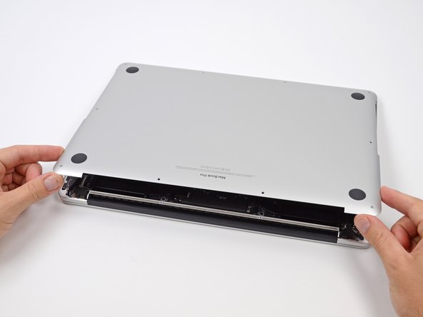

  • Lifting from the edge nearest the clutch cover, lift the lower case off the MacBook Pro.
  • Set the lower case aside.

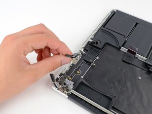

  • Insert the flat end of a spudger underneath the rubber heat sink cover on the right fan.
  • Slide the spudger underneath the length of the cover, releasing the adhesive.
  • Lift the cover and flip it back so that you can access the cables underneath.
Image #1 Image #2 Image #3
Add Note Edit Step 8  ¶
  • Use your fingers to pull the AirPort/Camera cables up off the fan.
    • The cables are adhered to the fan, so peel them up carefully to prevent ripping any.
  • Carefully de-route the cables from the plastic cable guide.
