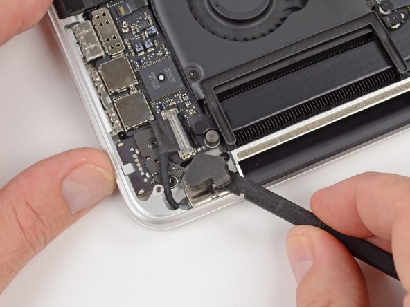

Add Note Step 18 — Rubber Hinge Covers  ¶
  • Use the flat end of a spudger to pry the rubber hinge covers up off the left and right hinges.
