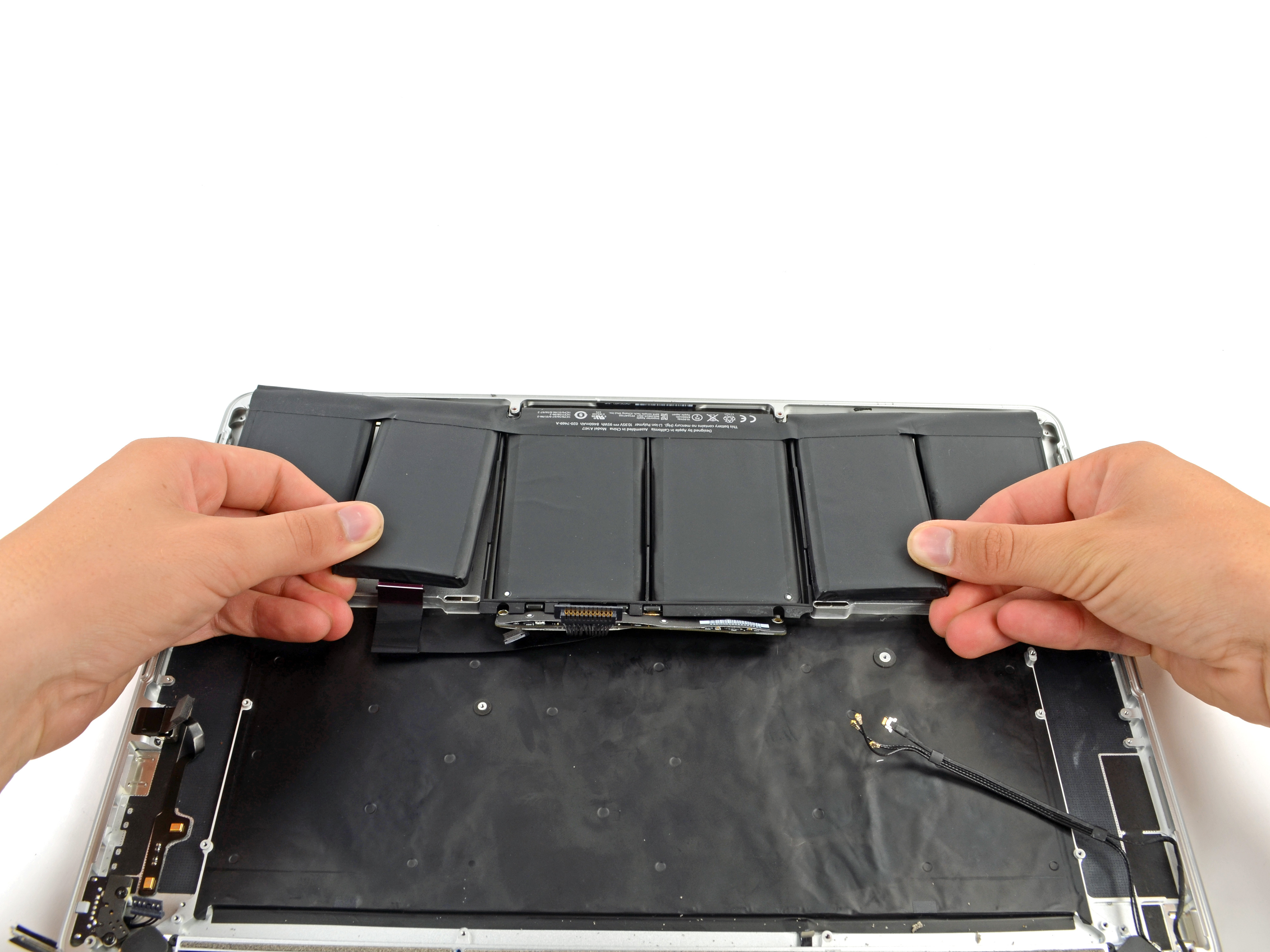

Add Note Step 9 — I/O Board Cable  ¶
  • Using the flat end of a spudger, pry the I/O Board connector straight up out of its socket on the logic board.
  • In a similar fashion, remove the I/O Board connector from its socket on the I/O Board.
  • Remove the I/O Board cable from the MacBook Pro.
