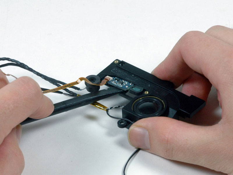

Add Note Edit Step 27  ¶
  • Use a spudger to pry the left ambient light sensor board out of its housing on the left speaker.
For more information, check out the MacBook Pro 15" Core Duo Model A1150 device page.
