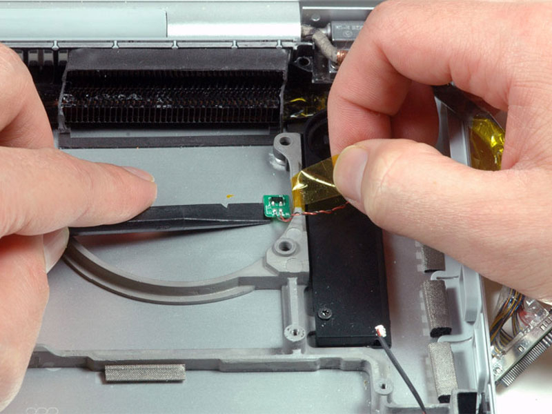

  • Disconnect the right thermal sensor cable from the bottom of the logic board near the DVI port.
first image
Add Note Edit Step 26 — Right Thermal Sensor  ¶
  • Peel up the orange Kapton tape covering the right thermal sensor.
  • Use a spudger to pry the right thermal sensor off the lower case.
