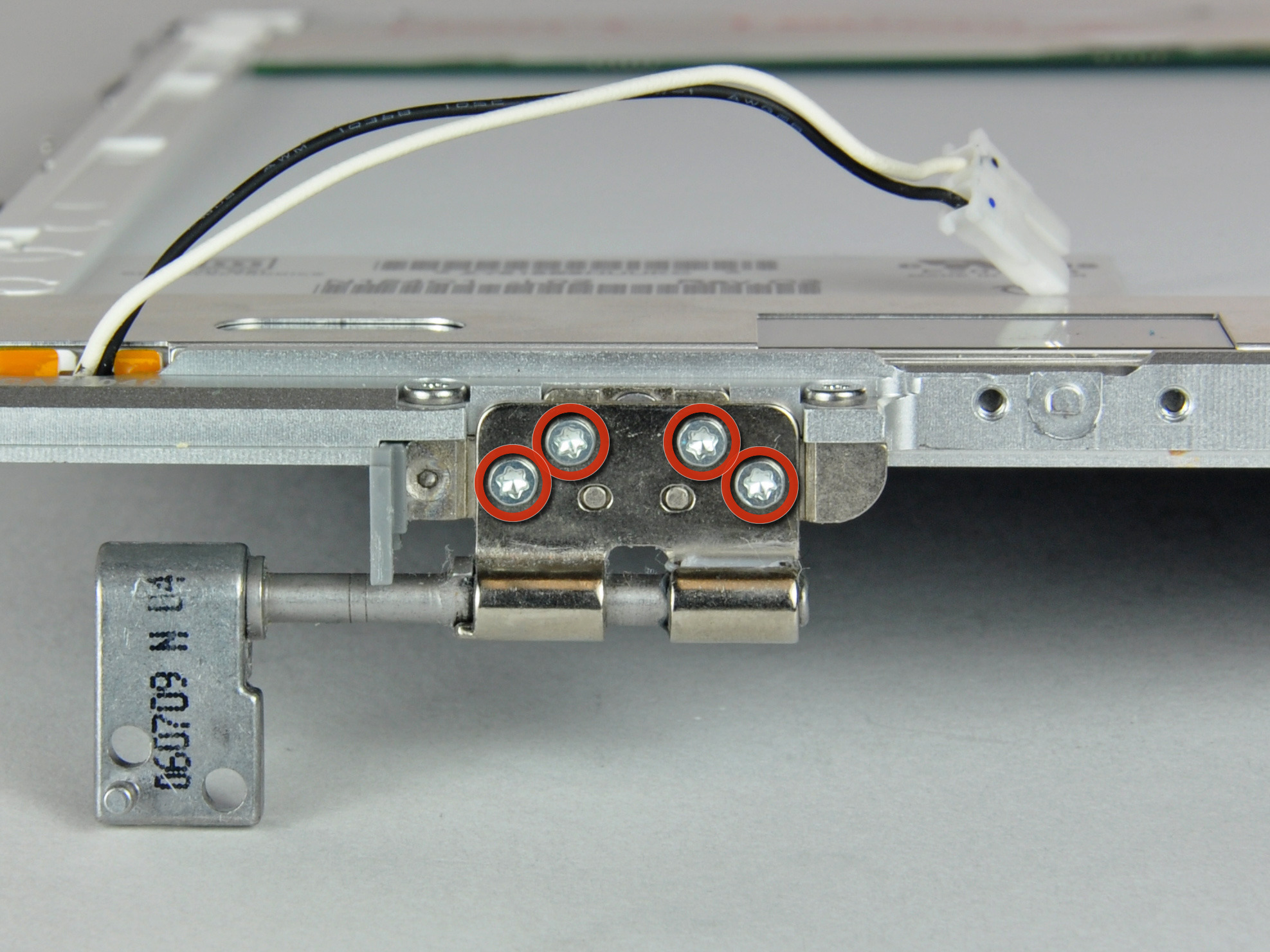

Add Note Edit Step 34 — Right Clutch Hinge  ¶
  • Remove the four T6 Torx screws securing the right clutch hinge to the front display bezel.
first image
Add Note Edit Step 35  ¶
  • Remove the right clutch hinge from the front display bezel.
