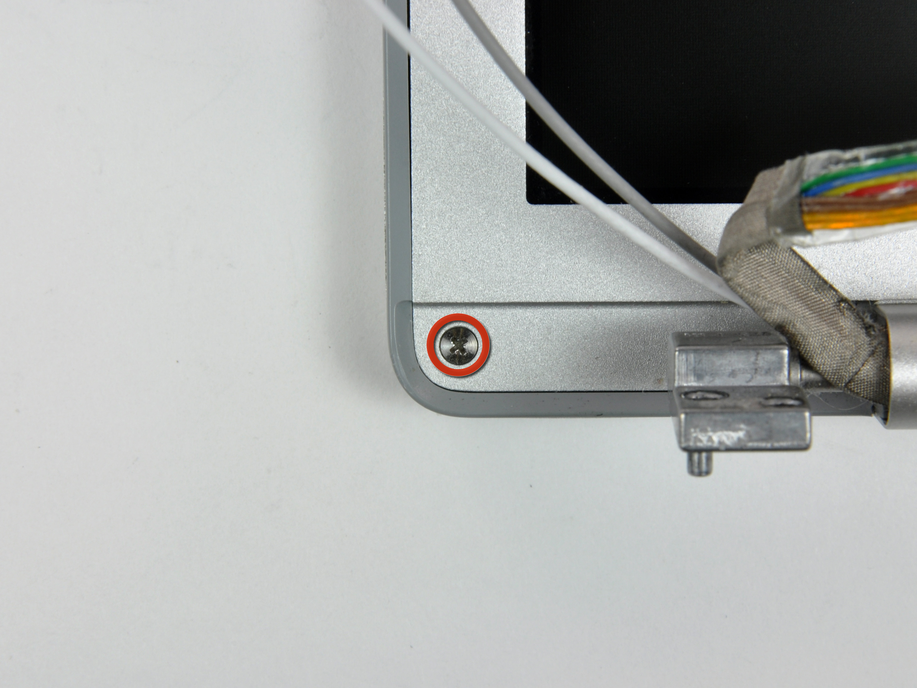

Add Note Edit Step 18 — Rear Display Bezel  ¶
  • Remove the Phillips screws from the lower left and right corners of the display (two screws total).
