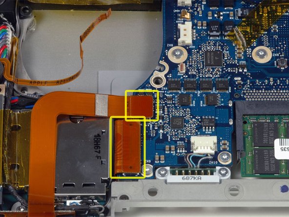

Add Note Edit Step 17 — Left I/O Board  ¶
  • Disconnect the hard drive and ExpressCard connectors from the left side of the logic board.
Image #1

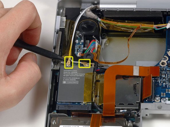

Add Note Edit Step 18  ¶
  • Disconnect the two antenna cables attached to the Airport Extreme card.
  • The white antenna cable connects to the left side of the Airport Extreme card.

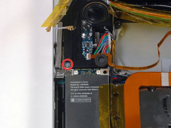

Image #1
Add Note Edit Step 19  ¶
  • Remove the single silver Phillips screw located just above the Airport Extreme card.
  • Lift the small silver metal retaining bracket up and out of the computer.

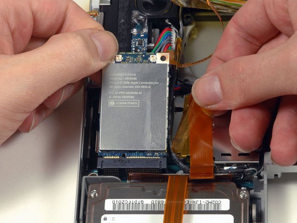

Image #1
Add Note Edit Step 20  ¶
  • Peel back the orange tape on the right side of the Airport Extreme card.
  • Lift the Airport Extreme card up and slide it out of its connector.

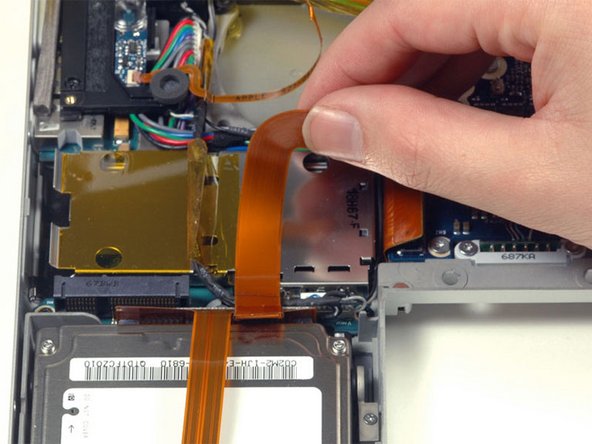

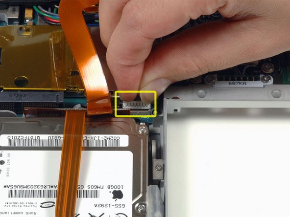

Image #1
Add Note Edit Step 21  ¶
  • Peel up the orange hard drive cable from above the ExpressCard cage.

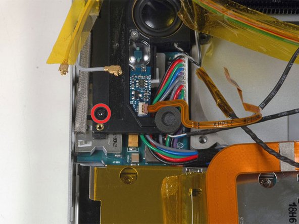

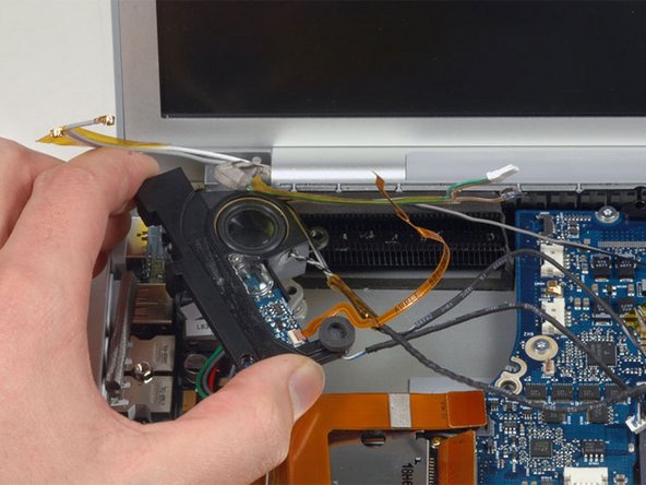

Image #1
Add Note Edit Step 23  ¶
  • Remove the single black T6 Torx screw securing the left speaker.
Image #1
Add Note Edit Step 24  ¶
  • Lift the left speaker assembly out of its housing and place it in the area previously occupied by the left fan.
