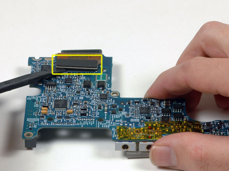

Installing MacBook Pro 15" Core Duo Model A1150 Left I/O Board Cable
  • Author: iRobot
  • Difficulty: Difficult
  • Add Note x
  • x 3
This connects the left I/O board to the logic board.
Sections
Tools
first image
  • Use your fingers to push both battery release tabs away from the battery, and lift the battery out of the computer.
first image
Add Note Edit Step 2 — Memory Door  ¶
  • Remove the three identical Phillips screws from the memory door.
  • Make sure to record which sets of screws came from where. This will help when re-assembling.
first image
Add Note Edit Step 3  ¶
  • Lift the memory door up enough to get a grip on it, and slide it toward you, pulling it away from the casing.
