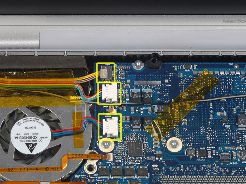

Add Note Edit Step 11 — Left Fan  ¶
  • Disconnect the iSight, inverter, and left fan cables from the logic board.
