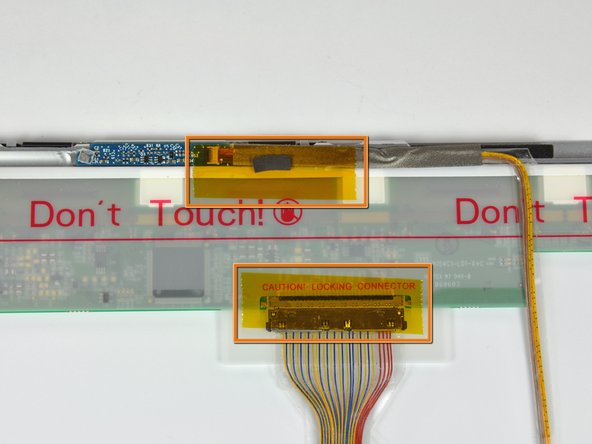

Add Note Edit Step 23 — LCD Panel  ¶
  • Remove the pieces of yellow kapton tape from the bottom left corner of the display.
  • Remove the pieces of tape securing the display data cable and camera cable to the display.

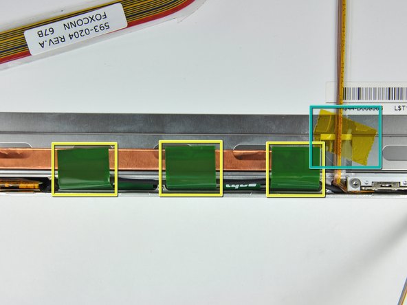

  • Peel the three green antenna ground straps off the copper tape along the bottom edge of the LCD.
    • The adhesive connecting these straps to the display is very strong. An edged tool is helpful to separate the adhesive while you peel the straps off.
  • Remove the piece of tape securing the camera cable to the LCD.

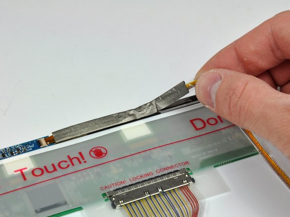

Image #1
Add Note Edit Step 24  ¶
  • Carefully peel the camera cable off the foam tape along the top edge of the LCD.
