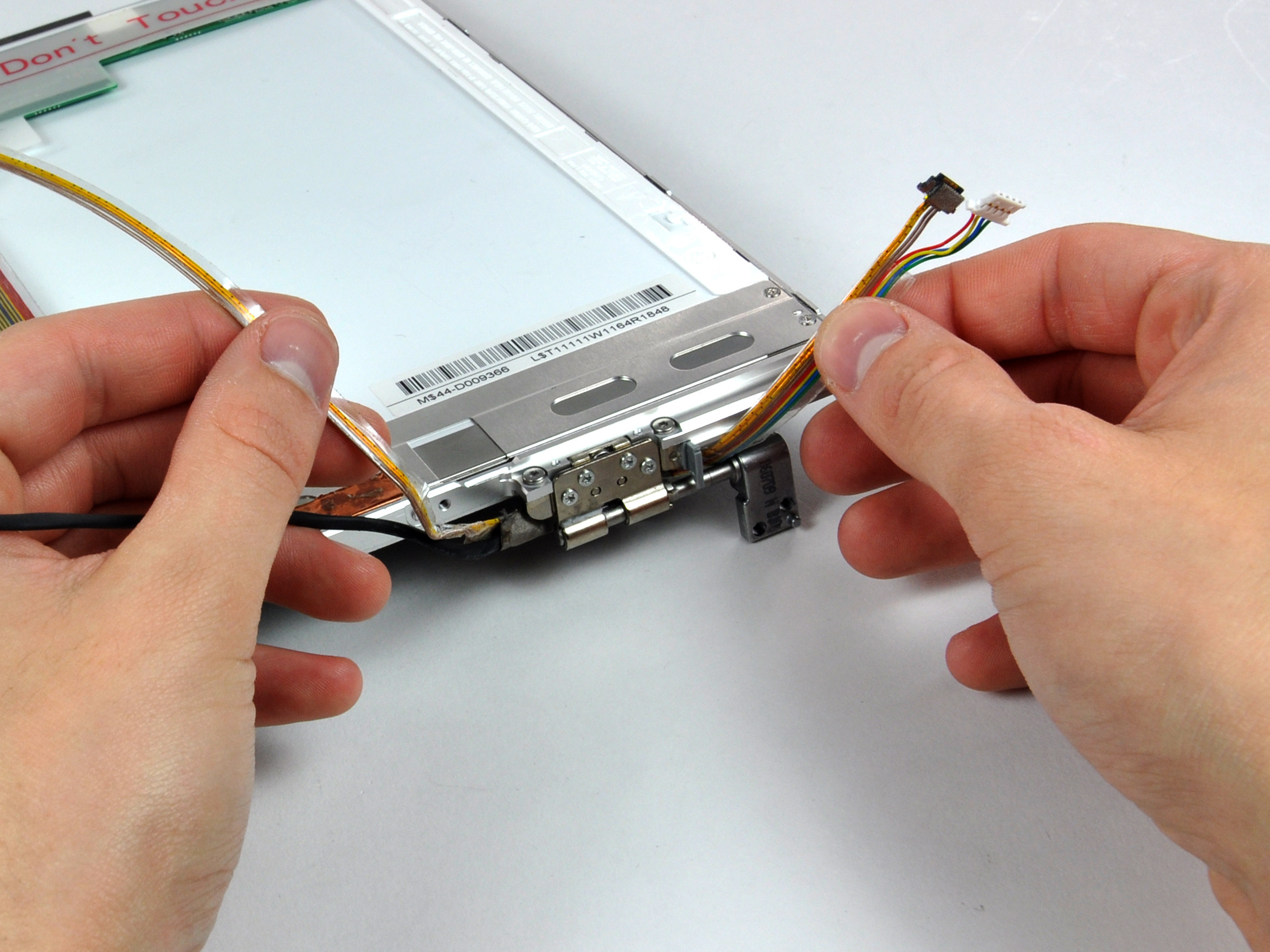

Add Note Edit Step 33 — Inverter/Camera Cable  ¶
  • De-route the inverter/camera cable from the left clutch hinge and remove it from the display.
