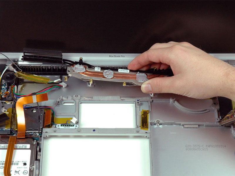

Add Note Edit Step 29 — Left Thermal Sensor  ¶
  • Peel back the orange Kapton tape covering the left thermal sensor.
  • Use a spudger to pry the left thermal sensor off the heat sink.
first image
Add Note Edit Step 30 — Heat Sink  ¶
  • Lift the heat sink out of the computer.
  • If you need to mount the heat sink back into the laptop, we have a thermal paste guide that makes replacing the thermal compound easy.
