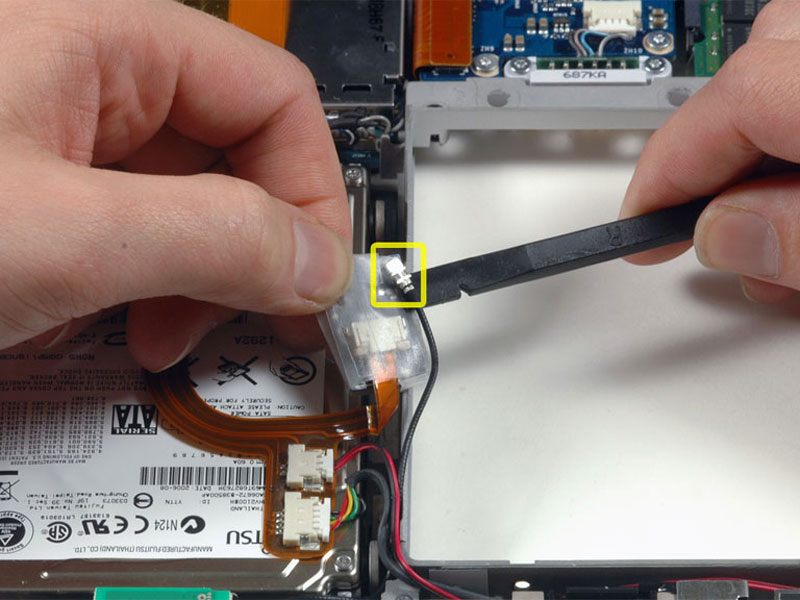

Add Note Edit Step 11 — Hard Drive Cable  ¶
  • Lift the Bluetooth board out of its slot next to the hard drive and use a spudger to disconnect the Bluetooth antenna cable.
