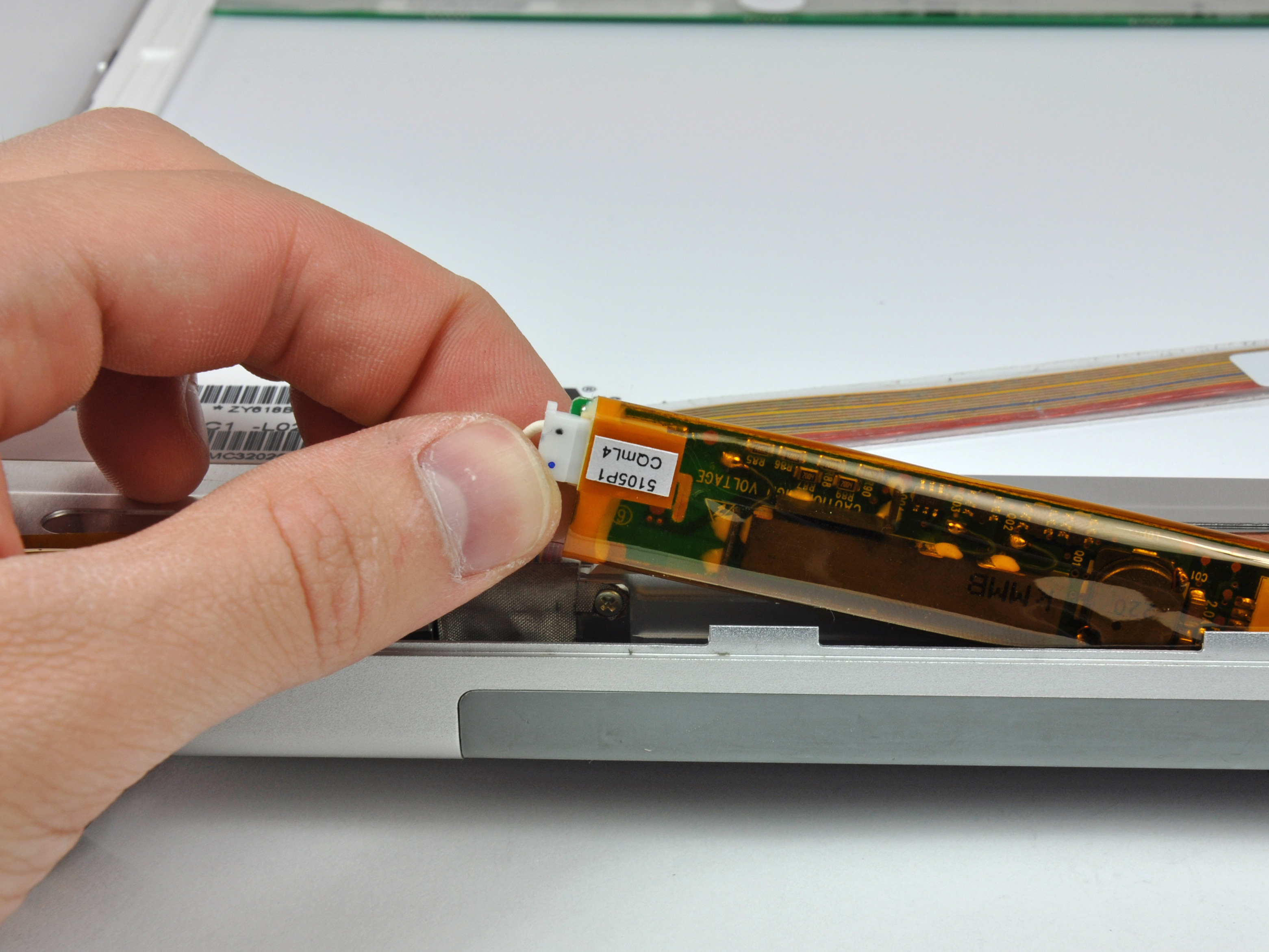

Add Note Edit Step 23 — Display Inverter  ¶
  • The display inverter is a very thin and delicate circuit board that is easily broken. Use caution when handling.
  • Carefully lift the inverter board out of the clutch cover.
first image
Add Note Edit Step 24  ¶
  • Disconnect the LCD backlight from the inverter by pulling its connector away from the inverter board.
first image
Add Note Edit Step 25  ¶
  • Be cautious to not put any strain on the inverter cable ground loop, as it is a very thin and delicate wire.
  • Disconnect the inverter cable by pulling its connector away from the socket on the inverter.
