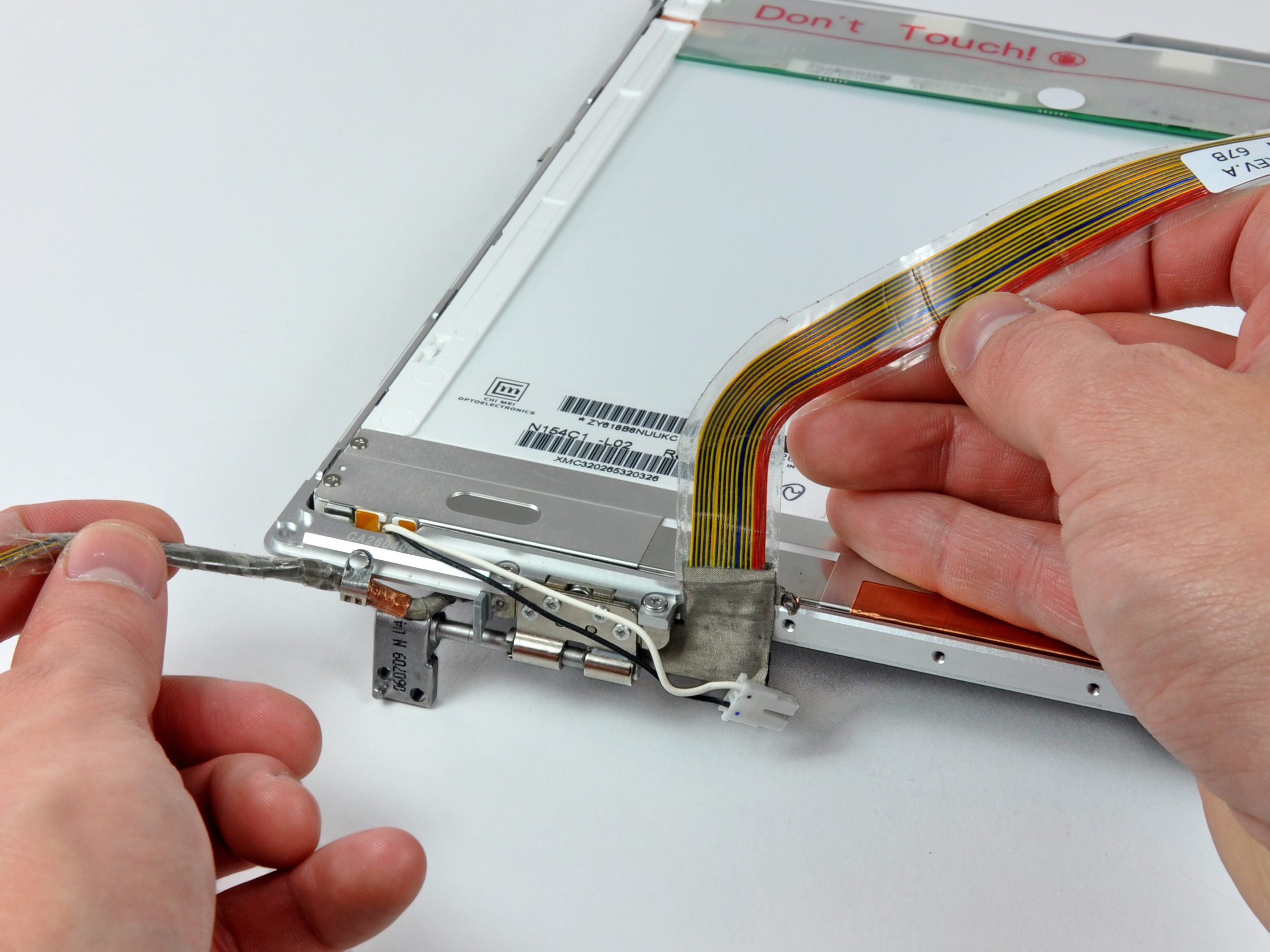

Add Note Edit Step 33 — Display Data Cable  ¶
  • De-route the display data cable from around the right clutch hinge and remove it from the front bezel.
