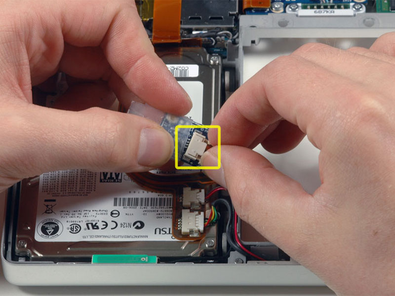

Add Note Edit Step 11 — Bluetooth Board  ¶
  • Lift the Bluetooth board out of its slot next to the hard drive and use a spudger to disconnect the Bluetooth antenna cable.
first image
Add Note Edit Step 12  ¶
  • Slide back the translucent plastic sheath to reveal the Bluetooth data connector beneath.
  • Disconnect the orange data cable from the Bluetooth board by sliding the locking mechanism slightly to the right to free the cable, and then sliding the cable out of its connector.
