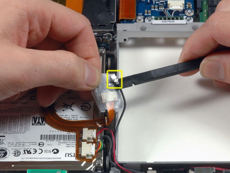

Add Note Edit Step 11 — Bluetooth Antenna  ¶
  • Lift the Bluetooth board out of its slot next to the hard drive and use a spudger to disconnect the Bluetooth antenna cable.
first image
Add Note Edit Step 12  ¶
  • Use a spudger to pry the Bluetooth antenna up from its housing in front of the hard drive.
  • Lift the Bluetooth antenna out of the computer.
