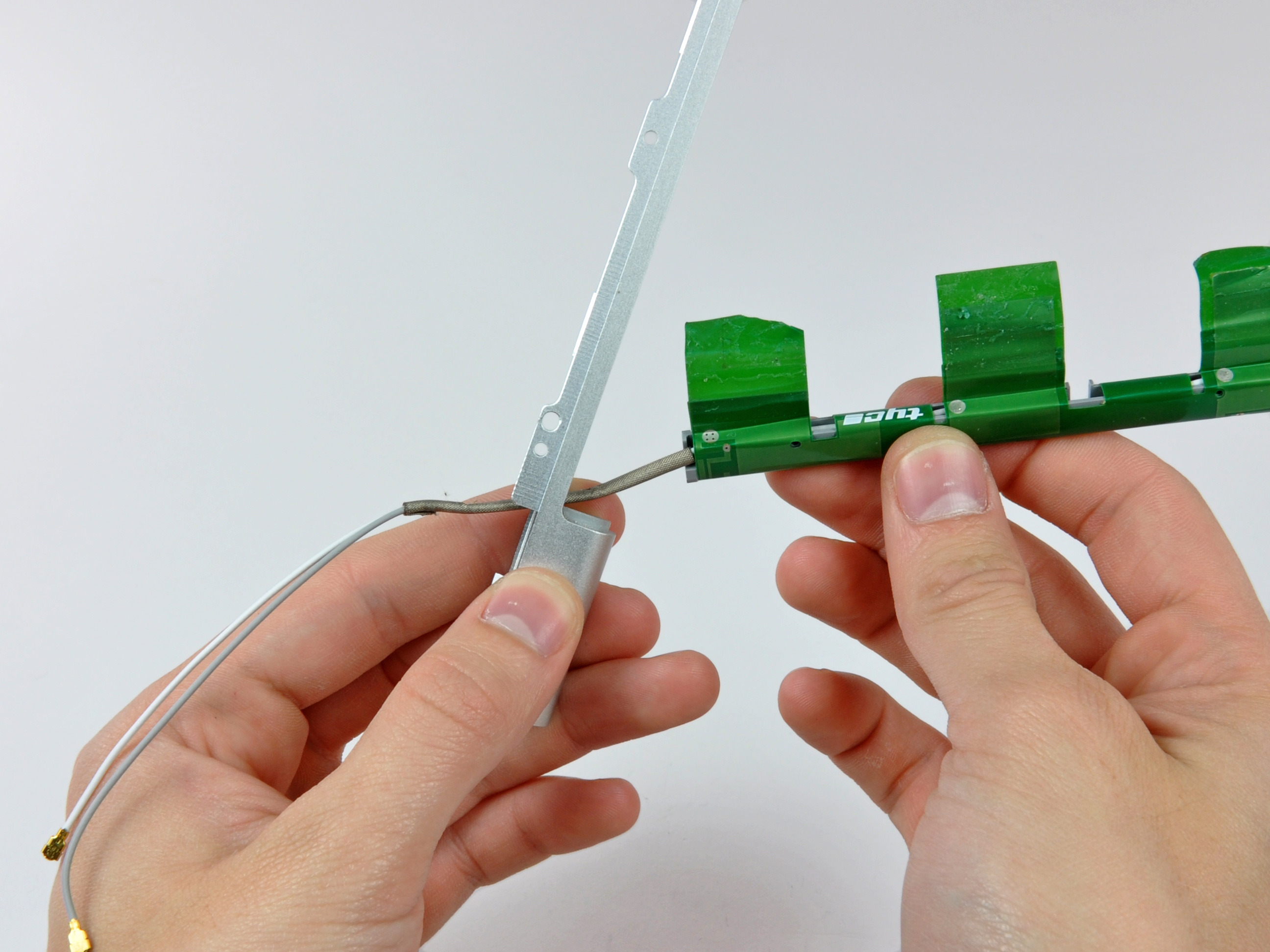

Add Note Edit Step 33 — Antenna Cover  ¶
  • Remove the five small Phillips screw securing the plastic antenna cover to the inside of the clutch cover.
first image
thumb image 1
thumb image 2
Add Note Edit Step 34  ¶
  • Pull the antenna cover off the clutch cover, being careful not to damage the antenna cables.
first image
Add Note Edit Step 35 — Antenna Cables  ¶
  • Remove the antenna cables from the clutch cover, minding the antenna connectors that may get caught on the clutch cover.
