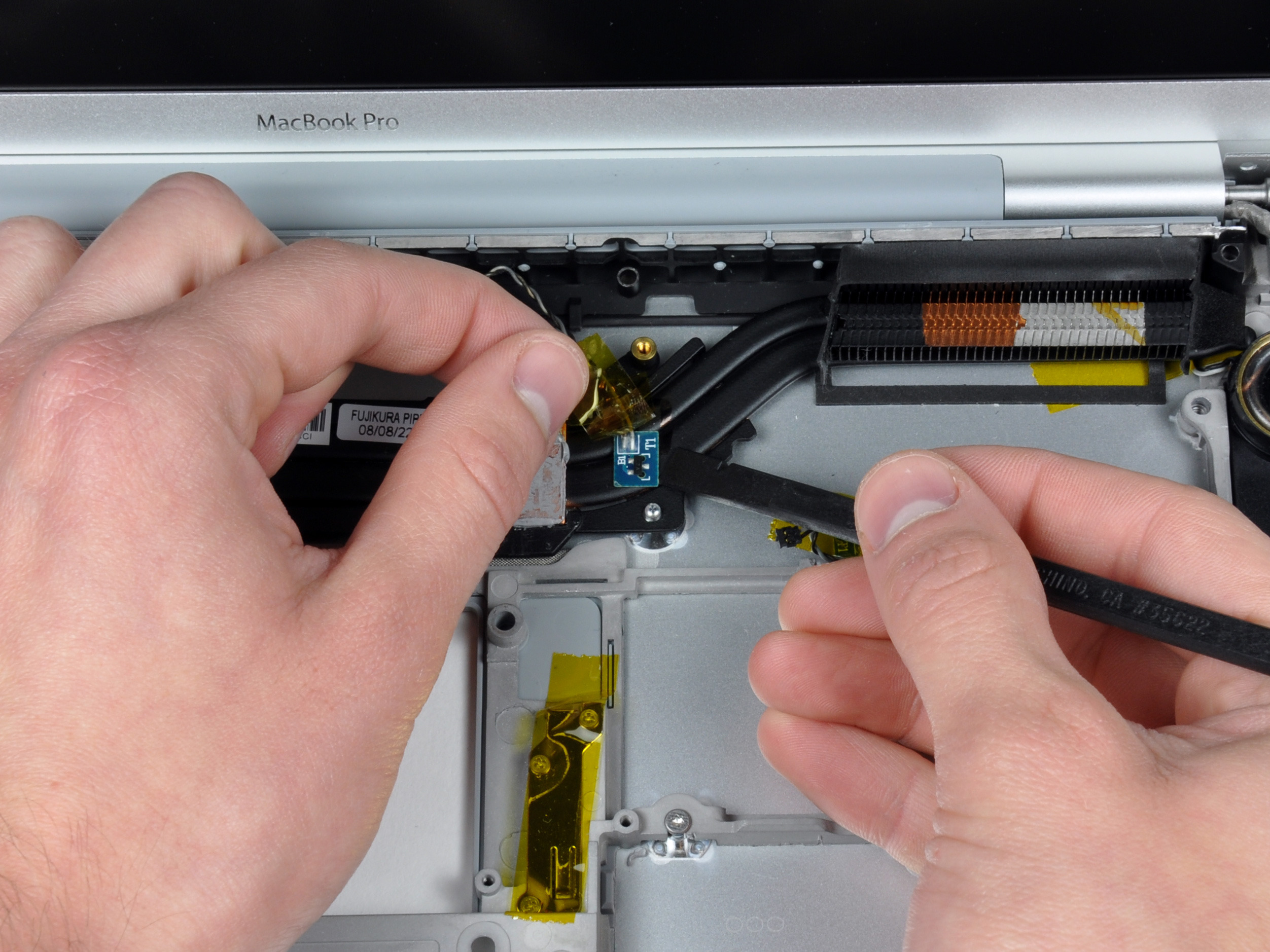

Installing MacBook Pro 15" Core 2 Duo Models A1226 and A1260 Middle Thermal Sensor
This detects the internal temperature of your machine for heat management.
Image #1 Image #2
