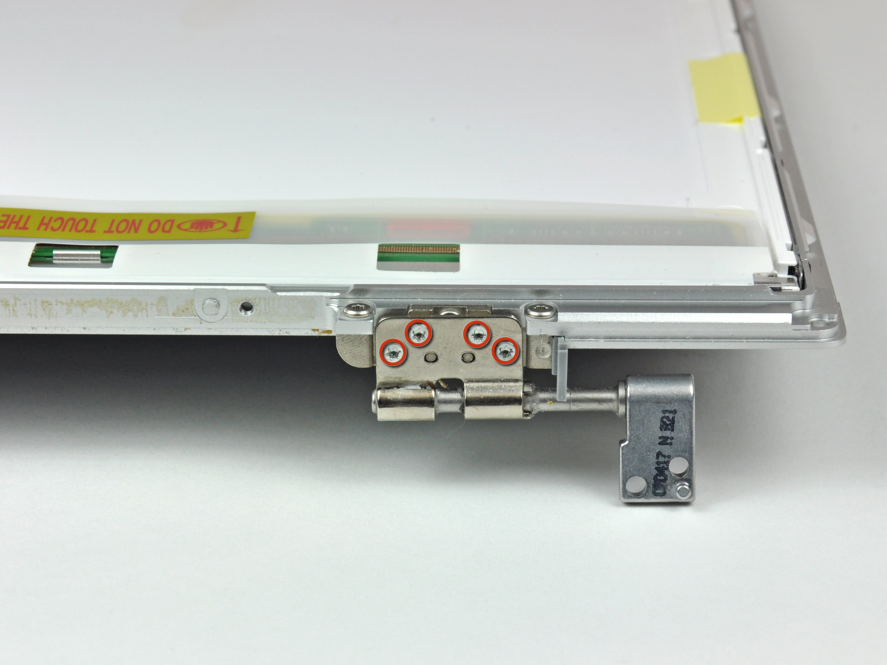

Installing MacBook Pro 15" Core 2 Duo Models A1226 and A1260 Left Clutch Hinge
- Author: Walter Galan
- Difficulty: Very difficult
Replace a broken clutch hinge to keep your display opening silky-smooth.
