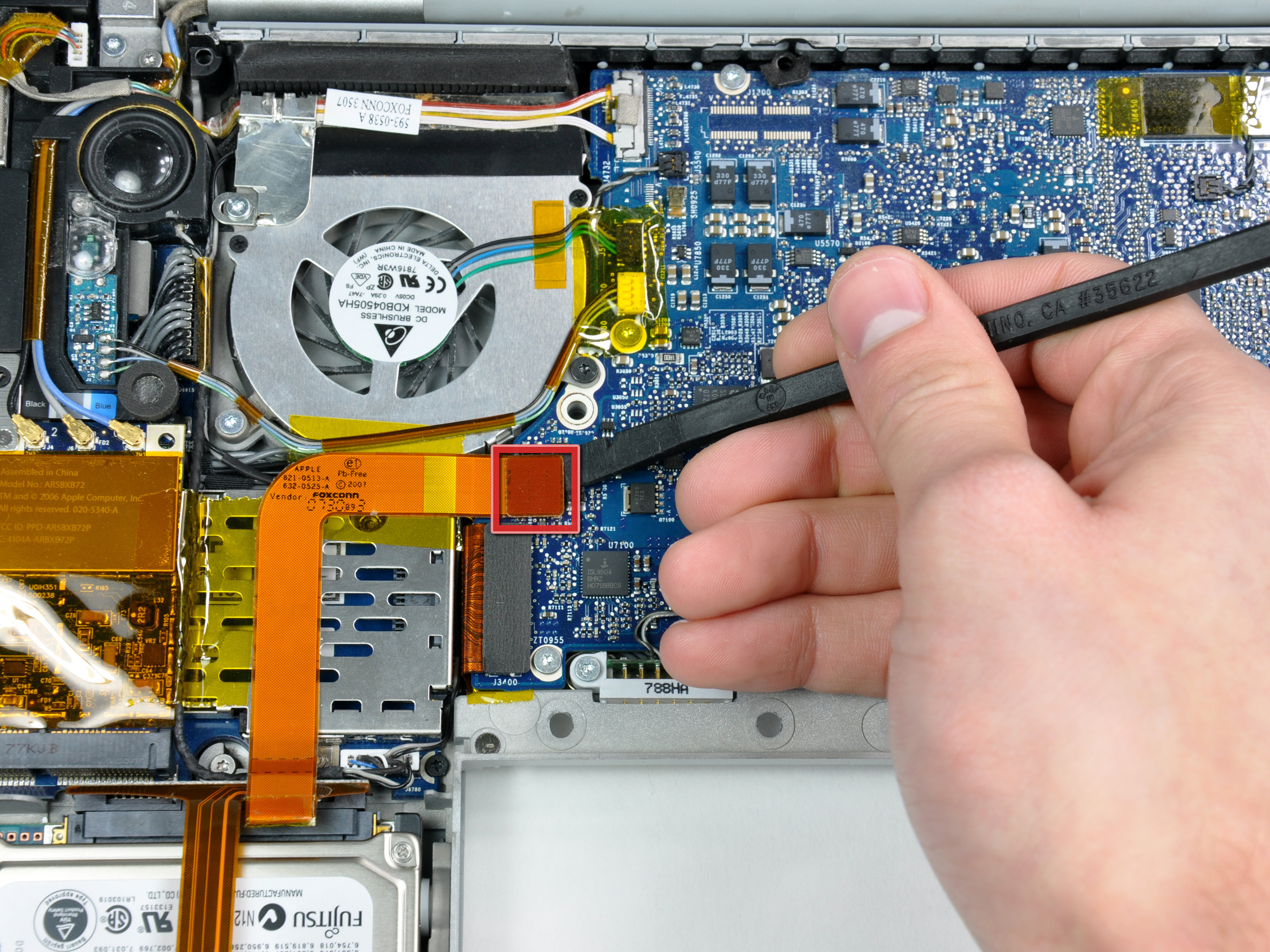

Disconnect the hard drive ribbon cable connector from the logic board.

Be careful when you'll disconnect the SATA connector on the HDD itself: the area where the ribbon cable bends is quite prone to wear and tear.
After several disassemblies, I actually broke that ribbon cable by making a slight "cut" on the junction between the upper part of the ribbon cable (the one which goes from the HDD to the motherboard) and the lower part (the one which goes to the latch LED and IR sensor).
It took me quite some time to find that this ribbon cable was actually broken; as I had no HDD issues, I thought that it was fine. That's only when I found that I had no more latch LED and unrecognized IR sensor, that I carefully examined the ribbon cable, just to find that there was that little cut in the circuitry. Hopefully, I had a spare one, and you can still find it for a few bucks.
