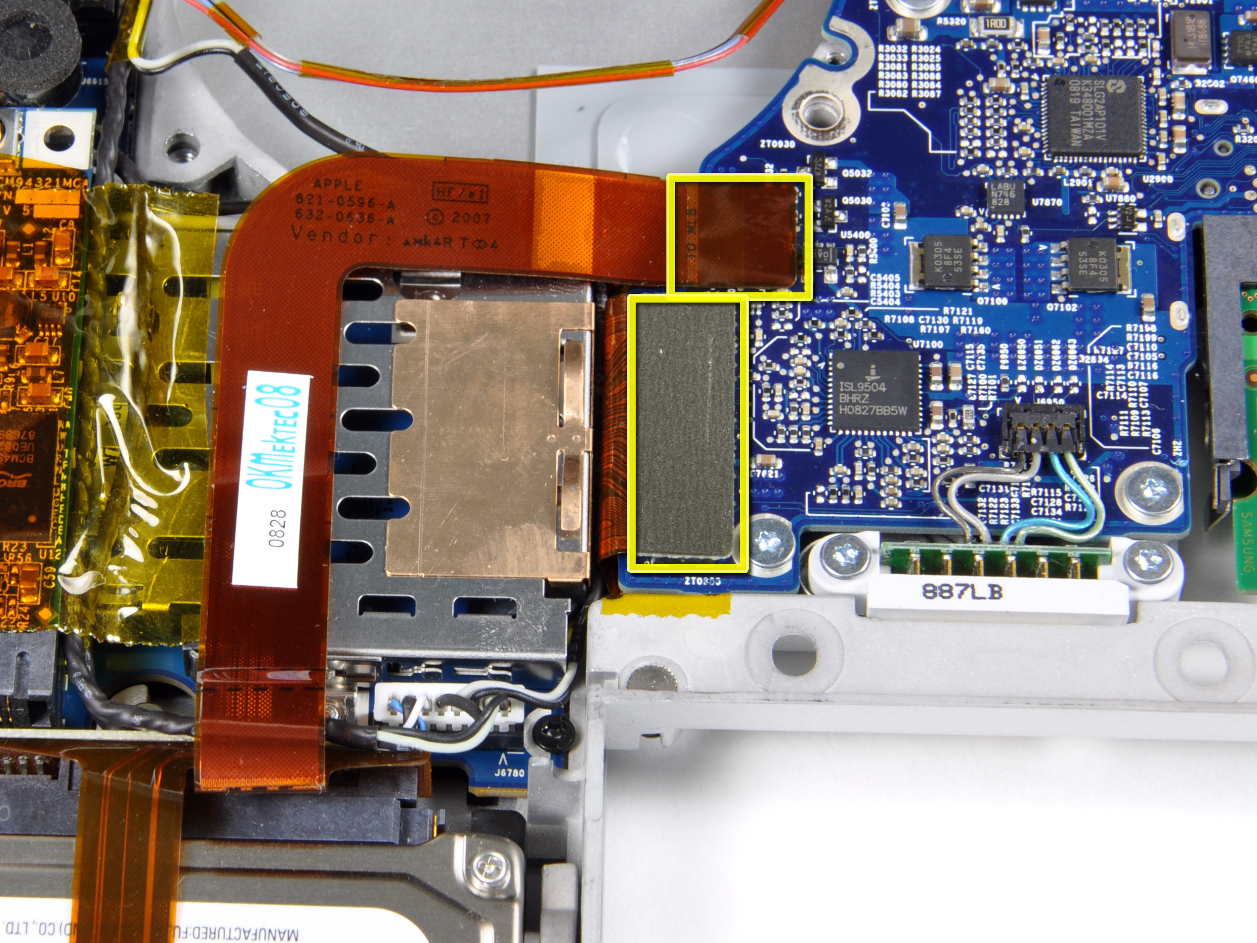

Add Note Edit Step 13 — ExpressCard Cage  ¶
  • Disconnect the hard drive and ExpressCard connectors from the left side of the logic board.
first image
